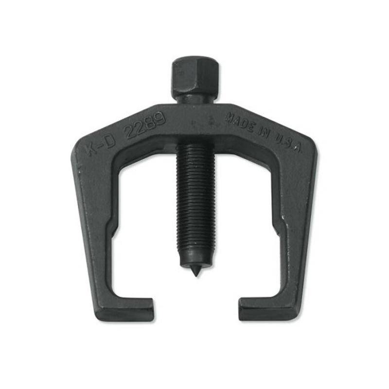

I assume you removed the rubber cap and then removed the shaft nut. It helps to lift the arm into the locked position just to take twisting pressure off of the shaft, but it is not required. I use a small gear puller and they come right off. It did seem like it would be difficult to get them off without one.

Rubber mallet. Don't need a whole can just a few drops right on top around the press fit where the nut sat. If all fails get a pulley as suggested above. It will get it off in a jiffy.
