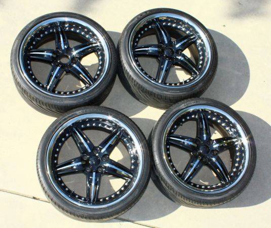

I found a deal on craigslist but dont think the rims will fit. Can i buy adapters? if so where and how much ?? also will the rims stick out and look funny if so ? I want it to look flush
here is the description and pics
....19 inch Foose wheels with high performance ZR rated Vredestein tires.... 2 of the tires are 235/35/19 and have about 90-95% tread left.... The other 2 are 265/30/19 and have about 75-80% tread left. The bolt pattern is 5 x 112 and they will fit all Mercedes models, some Volkswagen and Audi models and the Chrysler Crossfire....
If the offset is high enough, yes, without the offset, can't tell
Then he needs to take them to a good shop which sells wheels, have the offset measured, and then communicate back to you with the results.
You need the wheel to be at least a 58+ offset. Most adaptors subtract 20 from the offset. So if the wheel was a 58+ then when the adapter is added it becomes a 38offset which is the lowest you want to go on the ls. If that makes sense.
I have stock 5 spoke with a 60+ offset with a 25mm spacer, which puts it at 35+ offset and I would say its at the absolute maximum.
