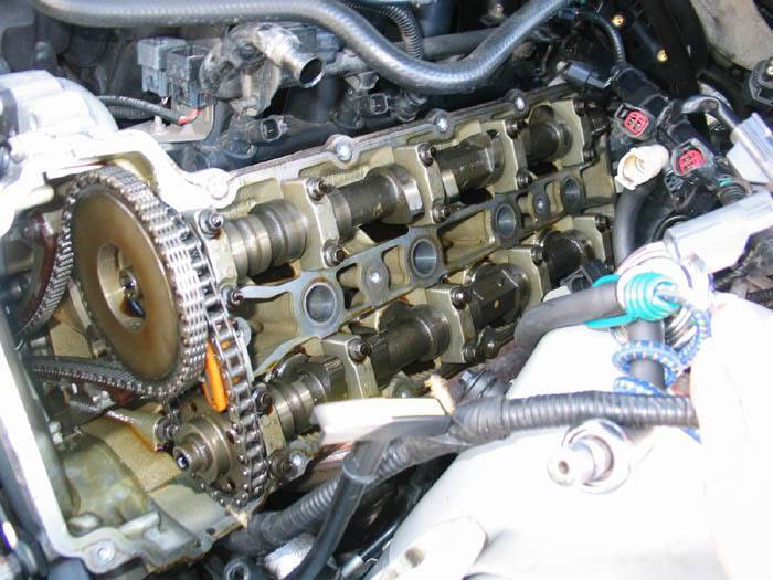

My cam gear broke on my 01 ls 3.9. Does anyone know where I can pick one up cheap? Also is this a reverse thread bolt. I tried to get the cam gear off and had no luck. I even used an impact gun and still no luck. Where can I get a tool to hold the cam gear while turning the bolt? Any help will be appreciated. Thanks...
The gear broke? Got pics?
You may have valve damage if the car was running when this happened.
To hold the shaft still you should use a special tool that holds the shaft in place in a certain position, but there should be a flat section about mid way that you can use an open end wrench to hold the shaft still.
The bolt should be a standard thread.

Great suggestions. I was trying to hold the the sprocket while losening the bolt and then the sprocket snapped. I did not know there was a place for an open end wrench. I will give it a try. hopefully I do not break the cam.

you are the man... It worked perfect. I held the middle of the shaft with a cresent wrench and it broke loose with ease. I was surprised to see thatv there is no key way for the sprocket. I guess it is just a press fit. Anyways thanks again. :bowrofl: :bowrofl:

I did not see one. I will take a picture of it. I am replacing the secondary chain and tensioner that broke.
