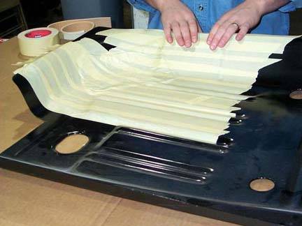

For most of us with the Maxima, the logical place for the fiberglass enclosure is the spare tire well. The first thing to do is to tape the area off to prevent any fiberglass or resin from getting on your car body. I highly recommend using 3M Brand tape. Trust me. Other tapes either don't stick or you can remove them. It really makes for an ugly mess. (Click on pics for larger images you can grab the top clear bar to move pics around)

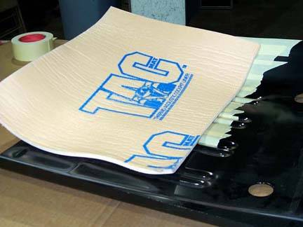

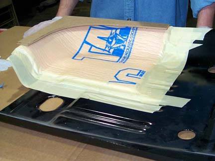

Step 2 Rough cut TacMat
Now you are probable wondering what does this product have to do with fiberglass. I have built many fiberglass enclosure and they had problems. While they were light, they sounded "pingy" and, well, like fiberglass. Another problem is that when you mold a fiberglass part into the car, it will creak and rattle as you go over bumps and rail road tracks etc. That's because your car flexes and the box doesn't. This is where TacMat comes in. TacMat is a material made by the Dynamat guys. This material creates a barrier between the fiberglass and your car that damps the fiberglass (giving you that less fiberglass sound) and provides a cushion between your fiberglass and your car.
WARNING! Don't try to glass to just any type of foam material. TacMat is one of a small list of foams that will not be destroyed by fiberglass resin. Most will. And the results will be disastrous.
Step 3 Form into shape
A real easy step but necessary. Press the TacMat so that it follows the contours of the floor panel. In the corners, you could use a little double stick tape (you do not need too much and too much will present problems later) You could also cut the TacMat into different pieces and spray glue the edges together. If you take the later step, make sure to overlap the seams by about an inch.

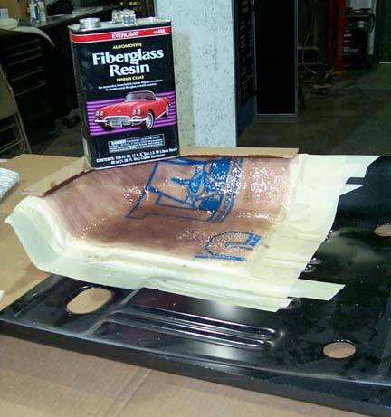

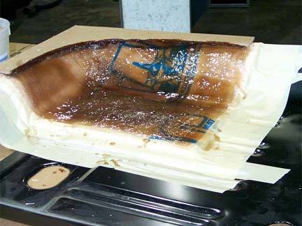

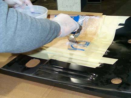

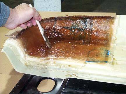

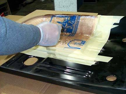

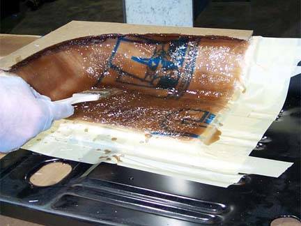

Step 5 First layer of fiberglass

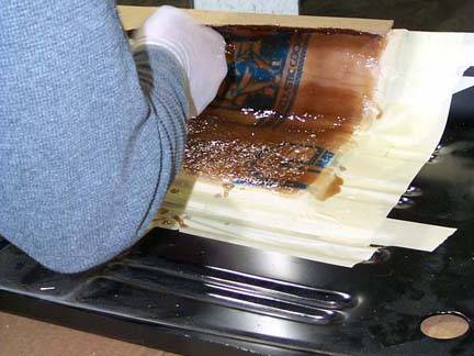

This step is easy if you have worked with fiberglass before. If not, test out your efforts on a little test piece. The experience you gain is worth the material you waste. I have seen many people try a big project like this and mess it up and waste big bucks.
Work with little strips up to 4" x 10" in size. Use 8 oz material. If you have 4oz, double it up or make two passes. Make sure to completely saturate the fiberglass with resin. The trick is to use just enough resin to saturate the mat. Too much and it will add unnecessary wait and be a little bit weaker. Too little and it will be very strong. Make sure to get resin between the fiberglass, TacMat and your wood trim ring. (This is an important step)
NOTE: A word on hardener. I probably use too much hardener. I take the recommendations and double it (or more depending on the temperature) Don't add too much or you could catch the resin on fire.

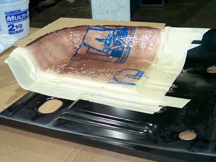

Step 6 Let the resin harden
I know, you can't wait to finish. Do rush! this is the time that it is easiest to make a mistake. Notice the resin can on the wood ring. I put that there to add some weight to make sure that there is a good bond between the fiberglass and the wood ring. Make sure that the fiberglass is dry to the touch before moving to the next step. If you cannot wait, make sure that it is hard but tacky.

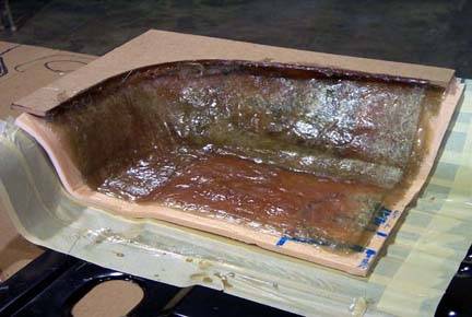

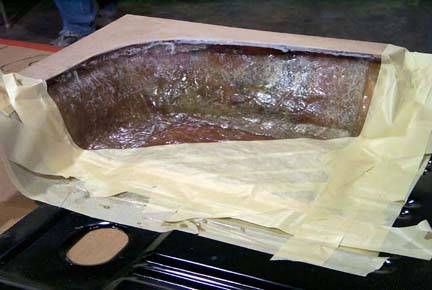

Step 7 Add glass to the underside of the wood ring
Use thin 1" strips and "tuck them between the underside of the wood ring and the fiberglass. This is where you wish you have the lip as close as possible to the edge of the fiberglass wall. (Makes it a whole lot easier) I use the tuck method.

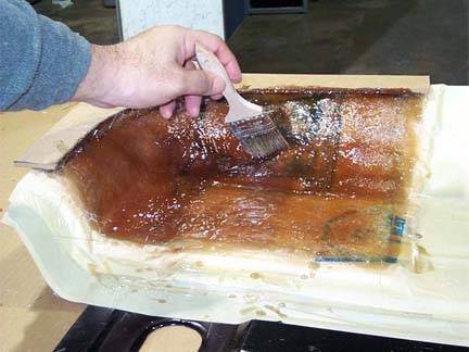

Step 8 Add a second layer
Repeat "Step 5" with a second layer of 8oz cloth.

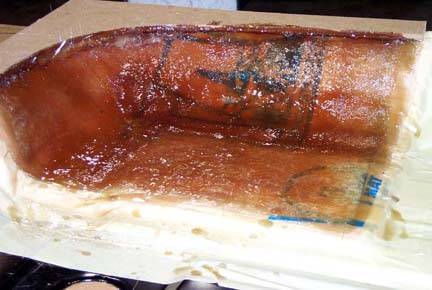

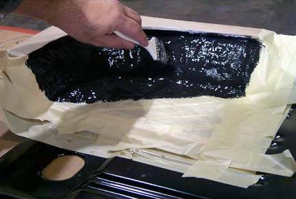

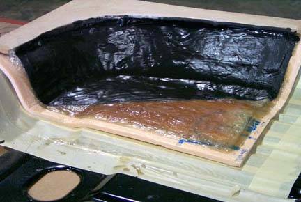

Step 10 Apply Dynashield
Dynashield is liquid Dynamat. This is a great use. The Dynashield sticks well to the fiberglass and further reduces that fiberglass "ring" that so many people have. Here I am using the kind from the Jug, but the can also works well. When using from the Jug, use a disposable brush and paint it on. I recommend about at least an 1/8" thick or about the thickness of a nickel. Dynashield is water soluble (won't catch on fire like other types of liquid damping material) and is non-toxic. It is also a great undercoating once dry.
Step 10 Let it dry
Dynashield with dry to the touch in about 2 hours. Complete dry time is about 24-48 hours. You could attach the top plate after a few hours. For best results wait overnight to use your enclosure.
