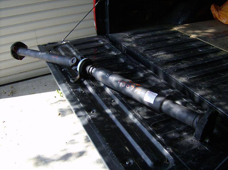

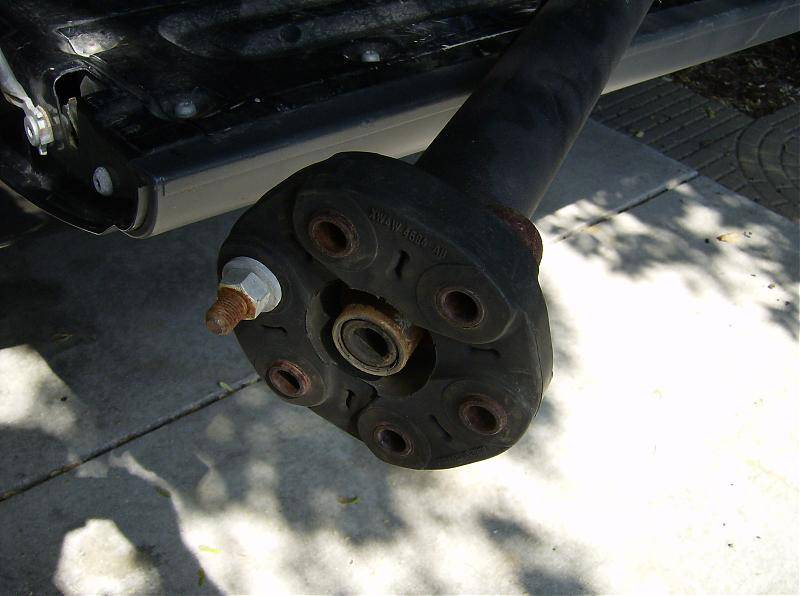

Exactly whats broken about the driveshaft I would ask. It has flex couplers on each end that could go and wouldn't require the whole driveshaft to be replaced and are fairly easy to change. It also has a center bearing and 1 u-joint by that center bearing. These are considered "not serviceable" by most places and would require replacing the whole unit. Rebuilding the shaft would likely cost more than a new one perhaps. I did buy a salvage unit for $80 though for the modification I did to mine.
Plenty of places can build and install one for you. Check local 4x4 shops since a lot of lifted or modified 4x4's requires customs driveshafts. If not then go to a u-pull-it and get one.
The 3 bolt flex coupler ends takes alot of the drive shaft places out of the picture. Only few have the equipment to work on them. The u-joint is a "stacked style" and is not serviceable but I did find a few places on line that at least claimed to be able to rehab the shaft replacing it with a seviceable one, same for the center bearing. Both would cost more than a new shaft, never checked but probably. Used shafts are very available, a salvage yard near me got me one in 1 day.

The U-joint is "staked". Rather than the clips to hold them in place they are staked as in the metal around the cap of the joint is punched into the caps, not to be unassembled again. I assume they are put together the same way just this being different. Kinda stupid really.
