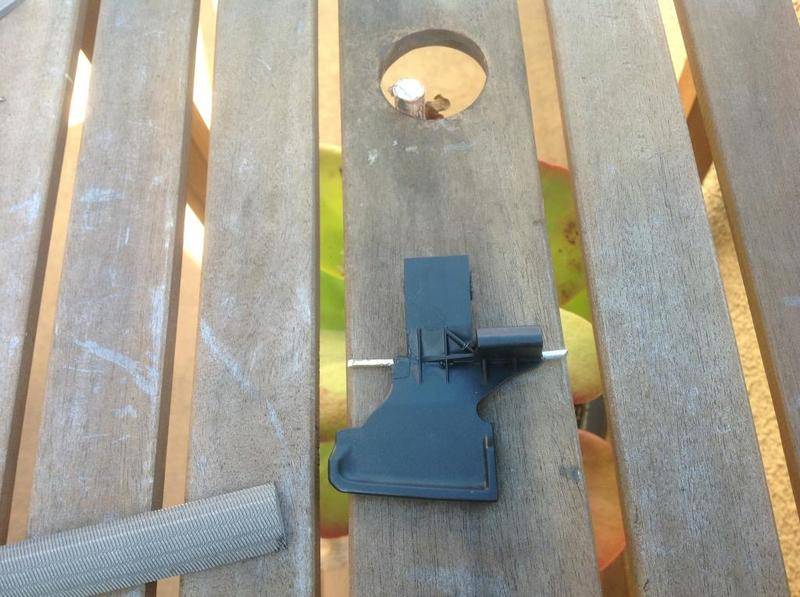

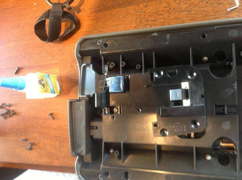

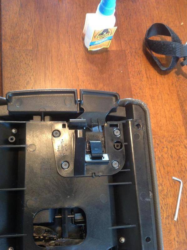

Got it done! Took my time with low setting on the drill and very small drill bits (progressively bigger). Turned out great and I think it will outlast the car. Best part is all it took was a nail and some super glue :)

Thank you for this. My pins snapped this week. Tried using epoxy to put the pins on, but the force on the pins is too great. I bought the multi pack brad nails from Walmart ($8 CAD) different sizes. used the large nail, chopped them with plyers and put them in. Didn't see the need for glue tho, they seem in place.
LOL! Happy I could help and the fix is still working 5+ years later on my end....wow how time flies!
