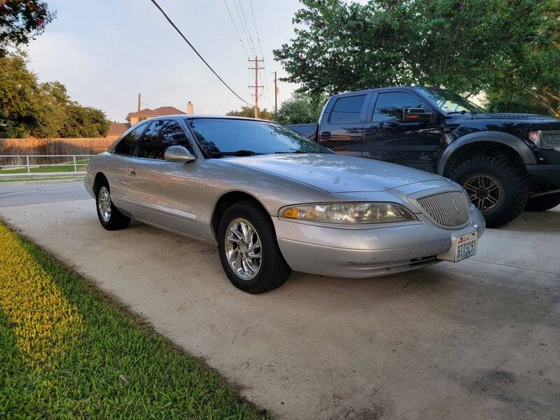

Here are a couple pictures of the car after my 2,200 mile journey home from buying it.
