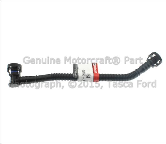

Does someone know if this is the correct part for the Vent hose connecting the EVAP Purge Valve to the intake in the engine compartment? This is on Ebay but only says it fits a 2003-2005 ...I have a 2006 so I'm unsure if this is the part I'm looking for I can post more pics of the location after work today if needed ...just let me know Thanks
No, that hose connects between the intake and the right valve cover. It is a PCV hose. The hose from the intake to the evap valve is very different. I'm looking for the part number.
Edit: I believe it is 6W4Z-9D289-AA
You’re right Joe, the one I did was Pcv like the picture. Thanks for the clarification I just googled the part # and saw the evap but everywhere saying discontinued but he already knew that lol.

Thanks for posting the part # much appreciated ... When Smokes mentioned it was discontinued I now remember you already said this on a different thread that was posted ...totally forgot ...and yes please keep me posted if you come across one at a pick&Pull somewhere
