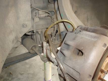

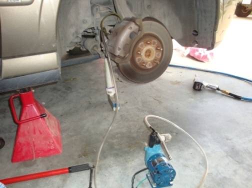

ok, fresh brake fluid is in. I ended up making a device to suck the fluid through (see pics). Just happened to have a small vacuum pump, and put a tank inline to catch the fluid. I had to turn it into a one person job.
