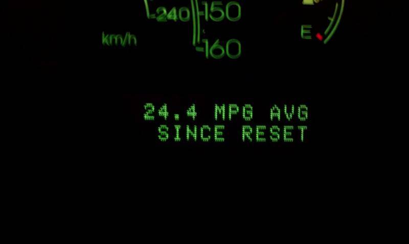

I went with that feeling and bought a good craftsman set from sears today and got some good stuff off the tech section here and I nailed it. Installed new plugs and new coils today and the car runs so, so much better. Like night and day really. I live in North Eastern West Virgina. The hills here on the interstate are a killer for MPG's. Even my friends civic gets low 30s at highway speeds, but as you can see with these new coils and plugs 24.4 was my average on a 40 mile interstate trip at 70 mph. I was getting 21-22 previously, much better performance indeed.

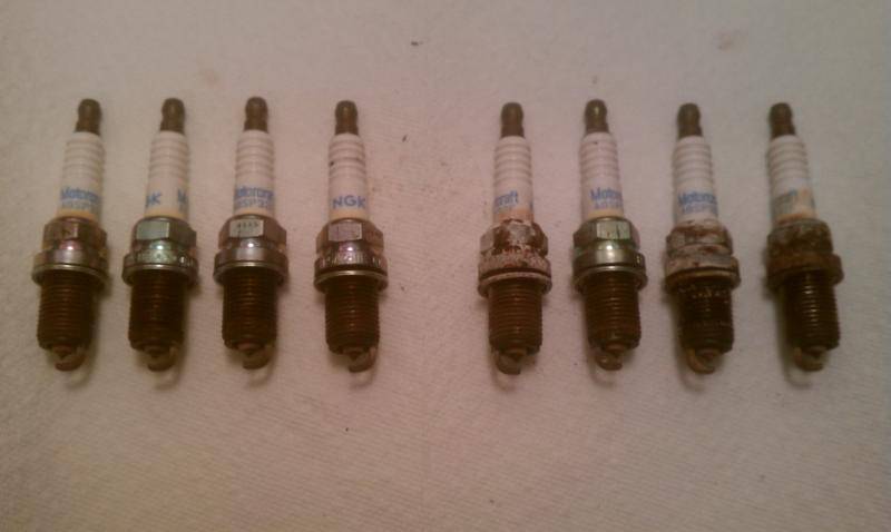

You also may recall me posting this thread. http://www.lincolnvscadillac.com/showthread.php?t=81878 about how a dealer told me I had moisture in my coils after I got my flashing CEL over some misfires. Well they wern't wrong.
You can see that 3 of those plugs from the drivers side bank of cylinders are pretty rusted, you could even see a level on the tube of the coils where some rusty water was. After talking with my dad we could only think that some dealer used a pressure washer to clean the engine before sale and that's how that much water could have entered. I had some canned air dusters and I got as much of the rust residue out of the plug opening that I could, and cleaned up everything up around where the coils go. Then I didn't hesitate to use a good bit of silicone sealant around the covers before I put them back on.

You may want to check your seal on the hood that goes over the cowl. It may be missing or torn allowing water to leak into the engine compartment. USUALLY dealer will use a steam cleaner to clean the engine but there are some not-so-bright dealers out there.
