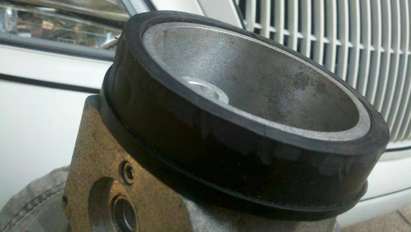

First I trimmed the rubber adapter ring and trimmed down the lip on one side so it will fit into air filter housing side that connects to the intake tube
Second I hogged down the threaded section and rounded off the edges

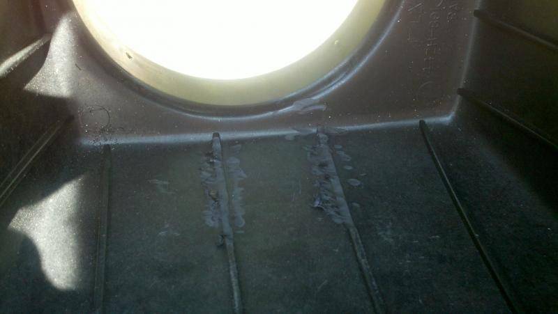

Third I cut down ribs on the air filter box to fit the sensor

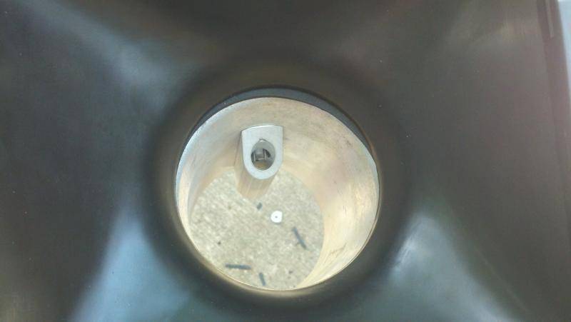

And last I put the cover back in, it's a little off center, but hey it works
