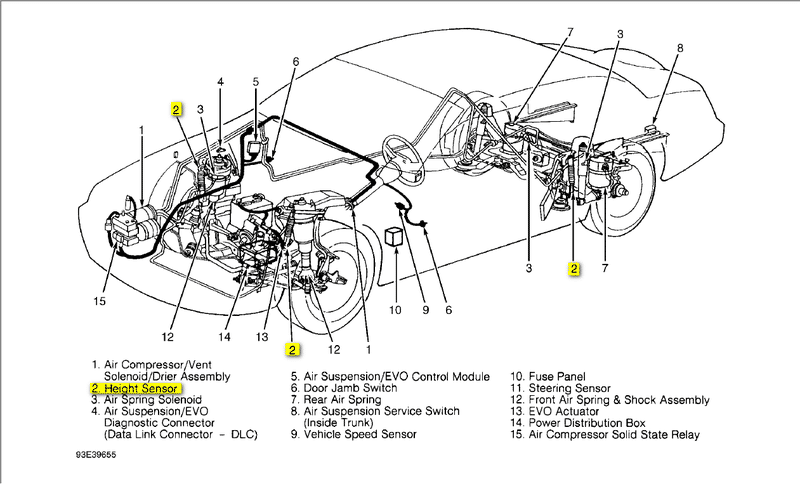

If your M8 was converted to springs, it depends on how much was removed of the air system and how it was removed. If it was cut out, you have to replace all air lines. If just the struts and air bags in the back were removed, you should have all the components still in your M8.
First look for the air compressor/dryer in the pass. fender. Then look for the sensors in the front wheel wells and one in the center of for the back bags.

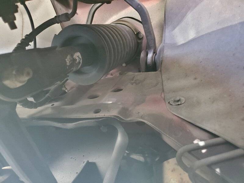

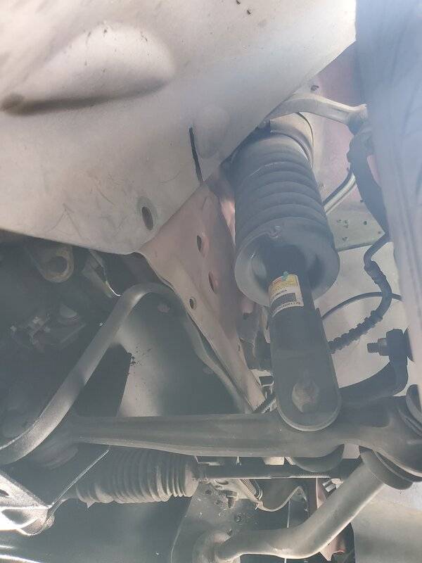

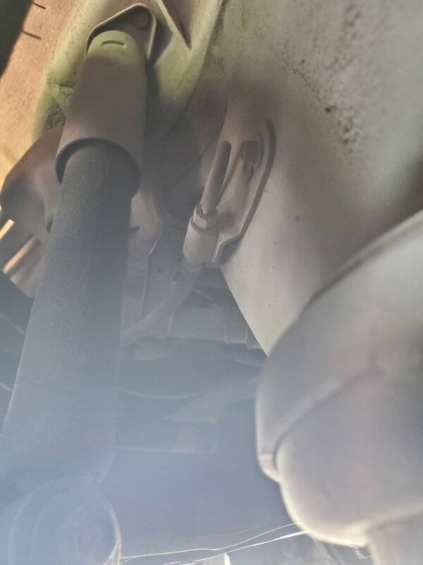

I got a chance to look under the car and took a bunch of pictures I don't know if any of them are useful though

Can you upload a pic of what I'm looking for on the passenger side? If possible I'm gonna pull the fender liner tomorrow and snap a pic to show you what I've got because the more I think about it all I'm more and more determined to reconvert to air.
I do not have any photos of the compressor but the attached will help you.
It has four air lines going into to it and has rubber isolators where it bolts to the frame.
