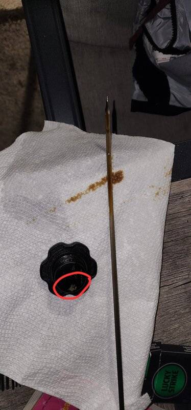

So I actually started looking at stuff now that I was home. The coolant is like a yellowish tan color and cloudyish. It genuinely matched the color of the degas bottle itself. I've been putting in 50/50 green. Checked oil cap for signs of coolant in the oil and there was a drop of goop on it. The oil itself looks fine on the dipstick. Went on a drive to temp the car and came home and let it run idle in the driveway for about 15 mins. No overheating issues. No smoke from exhaust. Started the car with the degas cap off and it didnt even bubble much less shoot water out. There was water leaking under the passenger side. I've had ac all the way off since I got back from the trip so it wouldn't cause a water drip. The puddle of oil has gotten progressively bigger over the past couple months but I assumed this is cause the valve cover was getting worse.
Picture of oil cap and dipstick with goop drop circled.

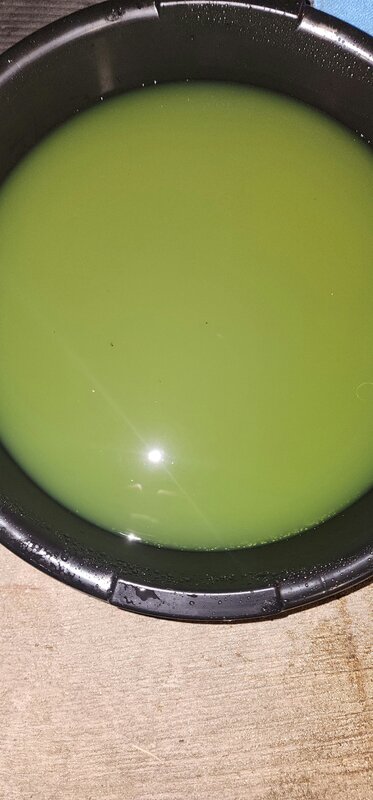

I decided to flush the coolant and this is how that process went.
I drained the radiator and this is what came out.

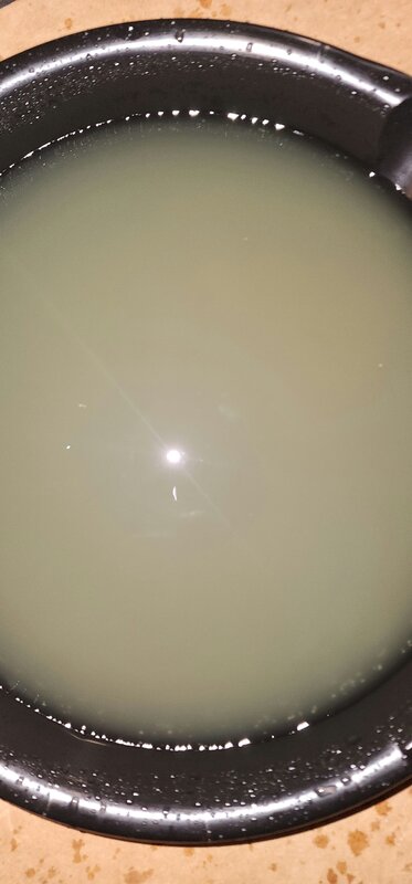

I then flushed it with a roughly a gallon of water until it came out clear and this is how that looked.
I'm not sure if this is normal as this is my first time doing this and my first car.

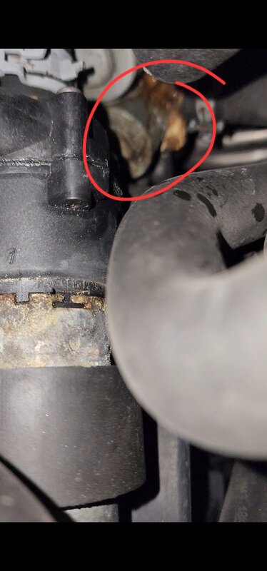

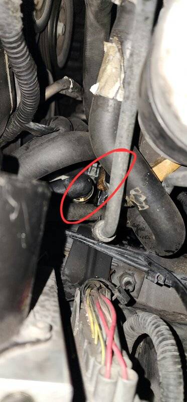

After this I looked up how to bleed and completely flush the system. In the process of reading I came across the dccv. From what I read it could be causing my no heat issue and maybe a leak from a hose but thats very uncommon. So I tried to get to it but its been a struggle. There's so many hoses and other stuff blocking it. After taking off the intake and upper radiator hose I finally could see it.
This is another picture I got of it.
The rusted part on the right side of the circle is the bottom of the dccv. It is completely rusted and it was wet. Idk if this is from when I removed the upper radiator hose or not. I would love to actually be able to get to this thing but there is a lot of hoses and I have no idea where to begin. I looked up tutorials and they had a lot of space compared to me and like 2 hoses. I'm assuming they were either 2nd gen or V6 version of the car.

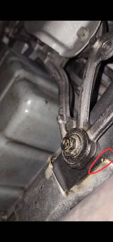

Now moving onto the heater core. This is a also a possible explanation for why my heat doesn't work and a coolant leak. But what gets me is that its just water leaking under the passenger side. No smell or color to it all.
This is where the water is leaking from under the passenger side. About 2 months ago I added an amp and sub to the car and when wiring it I pulled the carpet up on the passenger side and there was a wet spot. The carpet wasn't wet on the top but there was a wet spot under it. I have no idea if that could relate to this. I also know the whole dash has to come apart and im not very excited to do that if thats the problem.

No blend doors control air temperature. The DCCV controls that.
All plastic parts need to be replaced, now.
It should sound like a jet when the temperature needle is past the half way mark.
I didn't know that the car didn't have blend doors. Im almost certain that the dccv is bad for how it looks and knowing that it could be causing my heat issue. Fan sounded loud when I checked and the coolant was low but slowed down once the car got some coolant in it so its working fine.

Maybe that's why the drained coolant looks so nasty. Somebody may have put some "stop leak" in the cooling system.
Possibly some Aluma-Seal.
I was thinking the samething too. Especially since I added in total 2/3 of a gallon of 50/50 and it still looked like that. I know the previous owner was cheap and there was multiple things when I got the car that were not maintained to well and clearly were fixed with a "as long as the wheels turn" mindset.
