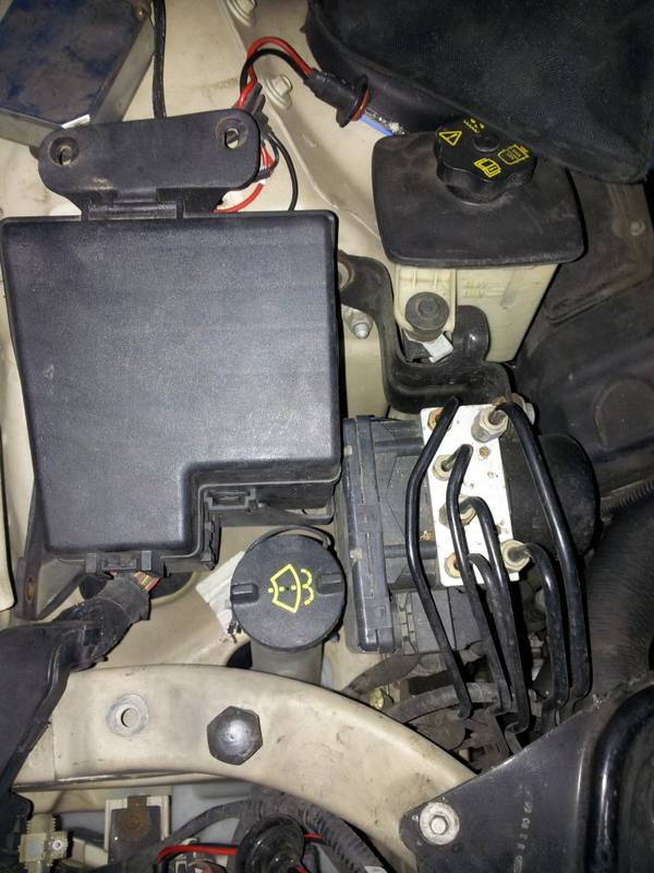

I couldn't find the feed bolt you guys keep referencing. Where would it be in this pic?
un bolt and remove the fuse box, inside of that plastic box, on the bottom, is the power terminal. (not just under the cover like replacing the fuse)
do you see where all of those other wires are going into it, that where your wire will also enter.
I took out the three bolts (two up top and one to the passenger side) and lifted the fuse box (as much as it would go). Are you saying it's under the whole box? Or are you saying it's inside the fuse box, under that first level where the fuses sit? I didn't separate the fuse box into two parts so maybe that's why I didn't see it? The fuse box has like four or five clips holding the two sections together. So unclip these and separate it?
"inside of that plastic box, on the bottom, is the power terminal."
ok, I get the message, sorry. I was just asking if I understood how and where. I'll try again tonight.
