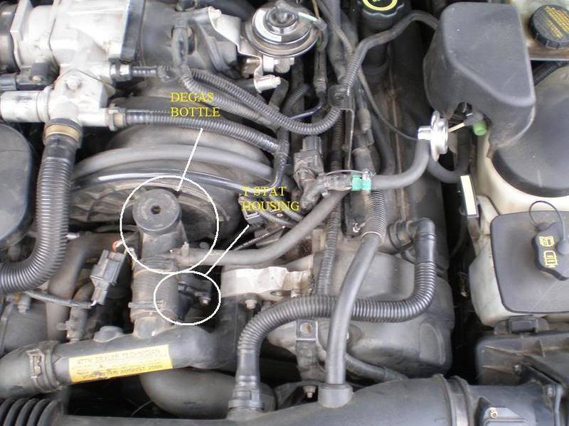

I don't know what year/engine you have, but mine is a 2000 (though 2002 is the same) V8. I replaced my tstat, but because the engine was overheating. Easy job. I took off the intake tube to make everything easy to access. The tstat is inside the degas bottle here:
well every few times i cold start my car after like 5 minutes of driving it the engine temp. goes to its overheating but it cant be. so i asked around and people said it was the thermostat
there could also be air in the system if it still does it after replacing the thermostat (they replaced mine for free). i parked on a steep hill facing up with the heat on high and filled the tank as the air came out. No overheating problems since. Just be sure to check the level whenever your under the hood to avoid letting air back in.
should you still have issues, you can have the system pressure tested.
