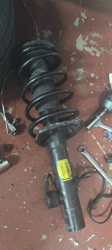

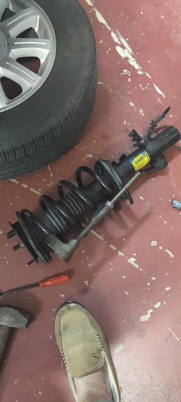

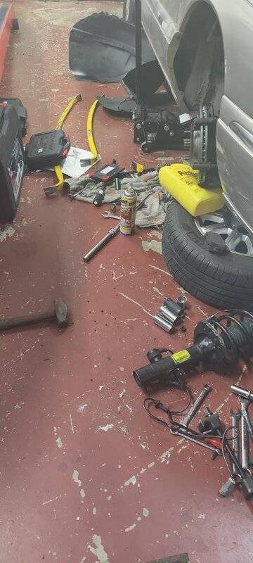

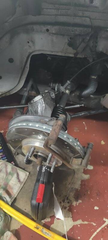

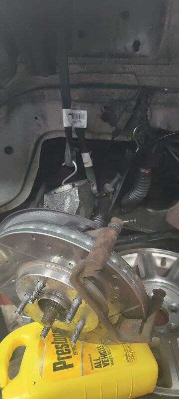

1999 LINCOLN CONTINENTAL FRONT BALL JOINTS, STRUT MOUNTS, OUTER TIE RODS, AND SWAY BAR LINK JOB IS COMPLETED....
It was a long weekend but this job is completed. Thank GOD for the Taurus ball joint removal tool. cannot imagine it is possible without it. Alignment came back nearly flawless with only a slight toe adjustment needed.
