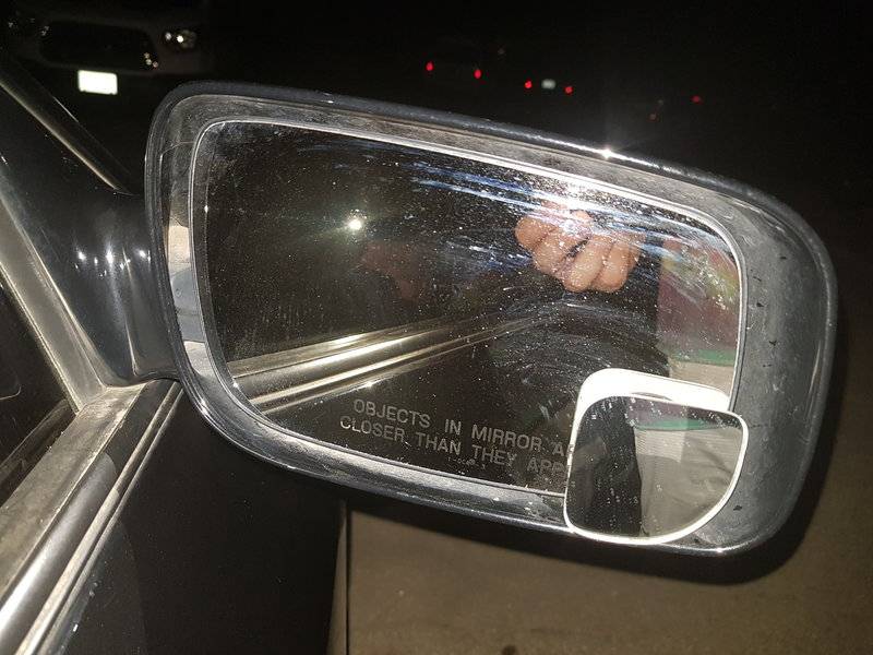

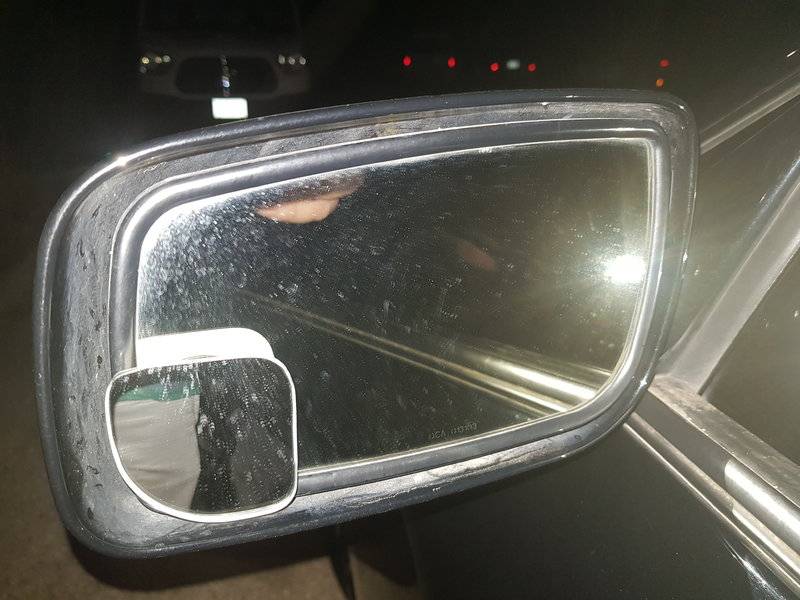

I'm not sure if that's how it's intended to be but based on that I would think so. However I do recall something about when I used FORScan to find my door code I saw an error about the VIN of one of my mirrors not matching my cars VIN.
I don't recall exactly what the error was, I'll do some more digging tomorrow to see if there's more info about it. If anyone has the automatic dimming mirrors can you look and see if your passenger side does and let me know below?
Both mirrors work fine and operate properly in terms of adjusting them, yet only the driver's side and rearview mirror auto dim.

I looked closer on mine and my driver's side has a gasket assuming for the electronics of auto dim but the passenger side does not
Hmmm, odd, that drivers side mirror looks to be a replacement possibly.
