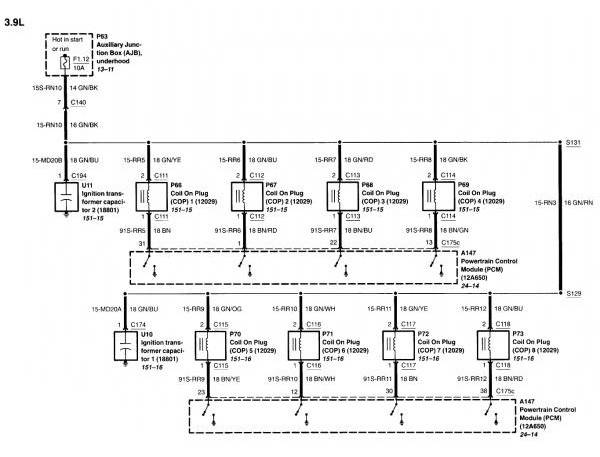

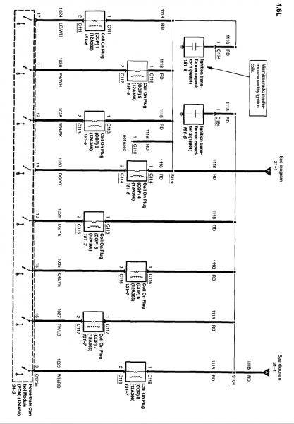

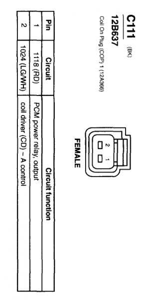

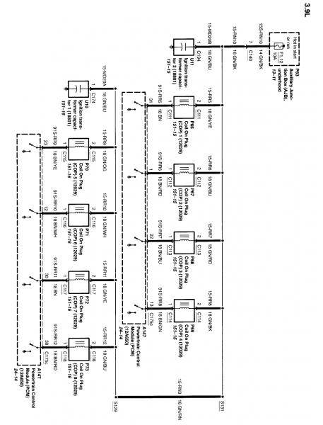

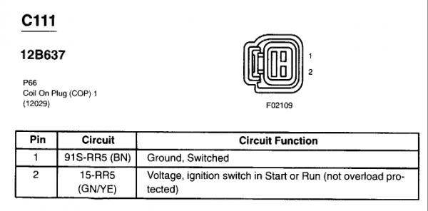

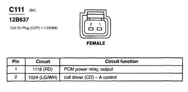

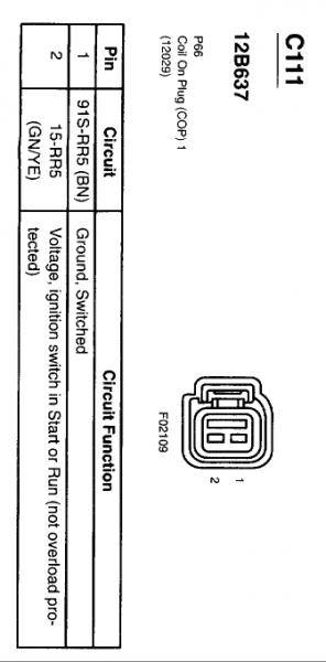

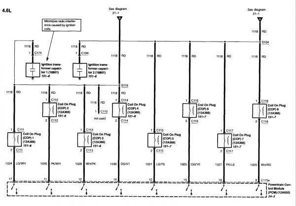

I saved some pics of diagrams from alldata, lets see if they will attach,
first 2 will be wiring diagram coils and connector view LS,
second set will be 2005 Mustang 4.6 wiring diagram and connector view
Okay, that shows both of them being switched ground setups, but the polarity at the coil connectors is opposite.
