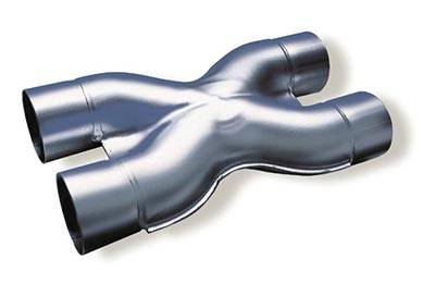

Here's what a traditional H-Pipe looks like:
Here's and a traditional X-Pipe looks like:

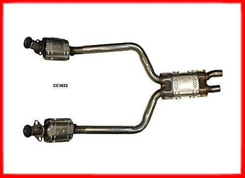

And here's what a Gen2 has under it:
Not really an H-Pipe, not really an X-Pipe, kind of a cross of both. I think you would have some power gain with an X-Pipe like the one I pictured, but how much who knows. Would need to find someone who swapped out and dyno'd pre/post swap.
If you want more noise you can eliminate the X/H pipe and run true duals. You will probably get a small performance reduction though. I know on the Gen 2's that Ford spend a lot of time tuning the exhaust. No clue on the Gen1's :)
i have a gen 1 so in your opinion would you go with an x pipe
I'd save the money and put a whole new exhaust under it instead of patching the stock exhaust. You might have some issues as it looks like there are resonators down there. An X-Pipe usually requires more room because of the way it's built. An H-Pipe can be very easily routed. You'd need to go to an exhaust shop and have them see how they could make it fit for you.
An X-Pipe should give better performance, but it might cost twice as much. But there is no right or wrong answer. Just a question of money, time, and performance.
