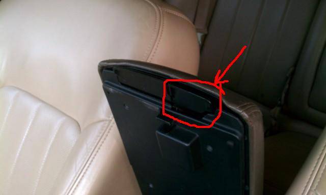

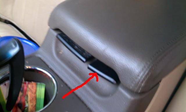

Anyone know of a good place to get a replacement part for the latch for an arm rest in an 05' LS? I opened it up and looks like the stabilizer pin for the latch is gone. Pics below. Thanks!
I know you are new here, so before you hear it from someone else, I will say it. You may want to search a little before posting these questions. The two you have posted so far are common issues that have been discussed already.
Anyway, the latch is not available individually. You will need a new armrest.
see post #11 on this link
http://www.lincolnvscadillac.com/showthread.php?t=57523
I replaced my armrest but others have glued a nail to the back of the pull handle. Someone suggested using Velcro to keep the top down.
Watch on Ebay, they come up occasionally, I paid about $55.
