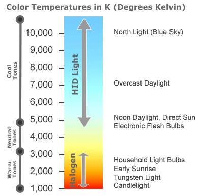

I have never seen them on the road but I have seen them a lot on track cars. They look good but I don't know what kind of light you would get from them. I sell the 3000K (golden yellow) HID conversion kits if interested. Here is a comparison chart on the color ranges:

I ran the 8000K, then the 6500K and now the 4300K. The 4300K puts out more light and is more like OEM. Remember, the higher the K value the lower the illumination. 8000K is too blue for normal driving. It looks cool but I want to see the road.
Does the "higher the k, lower the illumination" have a "centerpoint" so to speak? I've got to imagine getting into a 3000K is going to have lower output than your 4300K set as they are so yellow. Thinking maybe its "the farther away from pure white (4000-5000K) the lower the illumination". what do you think Ken?

You want to produce a color that is closer to natural daylight. That's how the human eye can see farther. You have cool tones, neutral tones and warm tones. You want to improve contrast at night. The neutral tones will do this which is closer to natural light. This means anything around 3200K to 4900K. Look below for the color temperature chart. The cool tones will produce less light output than the neutral tones. If you are looking for more light output go with a neutral tone. If you just want something cool, go with the cool tones. The 3000K will be very yellow which is warmer than the neutral tones. This will produce less light than natural light and won't tire the eyes like what you would find in a standard bulb in your house. The 3000K would be great for fog lights since fog lights are really just there for oncoming traffic to see the approaching car.
There are numerous HID websites that discuss this and this is what I have researched. You'll see many opinions on the subject but you'll find that most agree that you want to stay closer to the natural day light as possible for greater projection.
