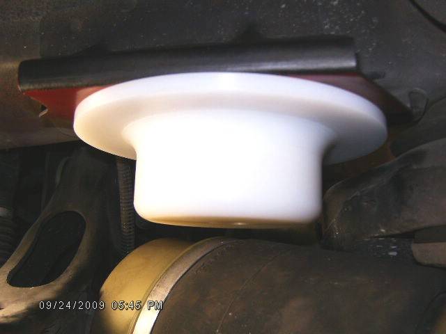

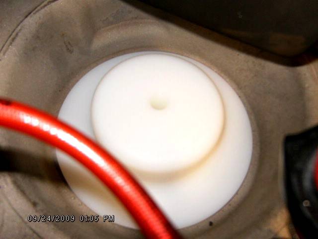

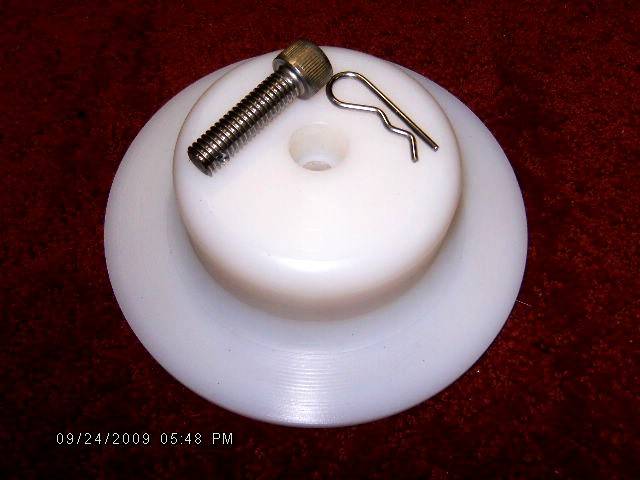

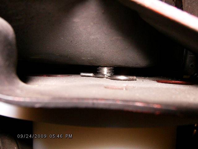

I know it's not cheap, but it is the best option. I can make them today and ship them tomorrow via USPS priority for $150.
i appreciate the offer but i can get a full kit for 200....... they seem very well made though. not having a job limits my options.
That is sweet!
even if I dont like coil conversions, that is a nice piece DLF well worth the money.
That is sweet!
Thanks! I also make the UHMW lower perches. I've been making them quite a while now for the T-Bird crowd that wanted to changeover to Mark VIII LCA's. Then I had a couple of people ask me to make them full sets of upper and lower perches ($300 :eek:) for Mark VIII spring conversions using T-Bird springs. Takes several hours to make each one, and the material isn't cheap, but I don't think there's anything nicer out there.
