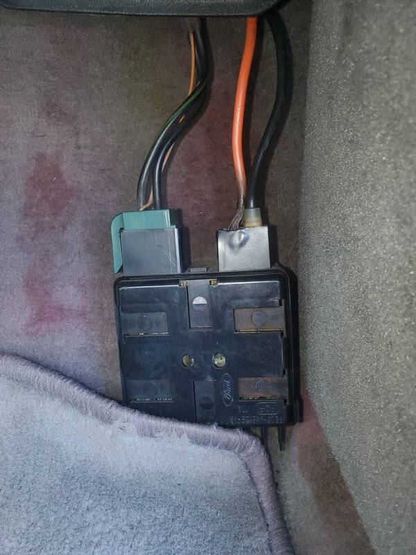

Anyone else rocking AC and Heat via this? The red power wire keeps coming out. Would you recomend JBWeld as a more permanent fix or what? Thanks.

If you haven't already done so, do yourself a favor and clean up those overheated wires with sandpaper or a fiberglass pen before crimping a new terminal onto it. The overheating of the wire is likely due to an intermittent or poor connection. Crimping onto unclean wires may cause another intermittent or poor connection. Also, if you can access the mating terminal in the module, make sure it is also clean and that the crimped connector makes a secure fit when plugged in.
