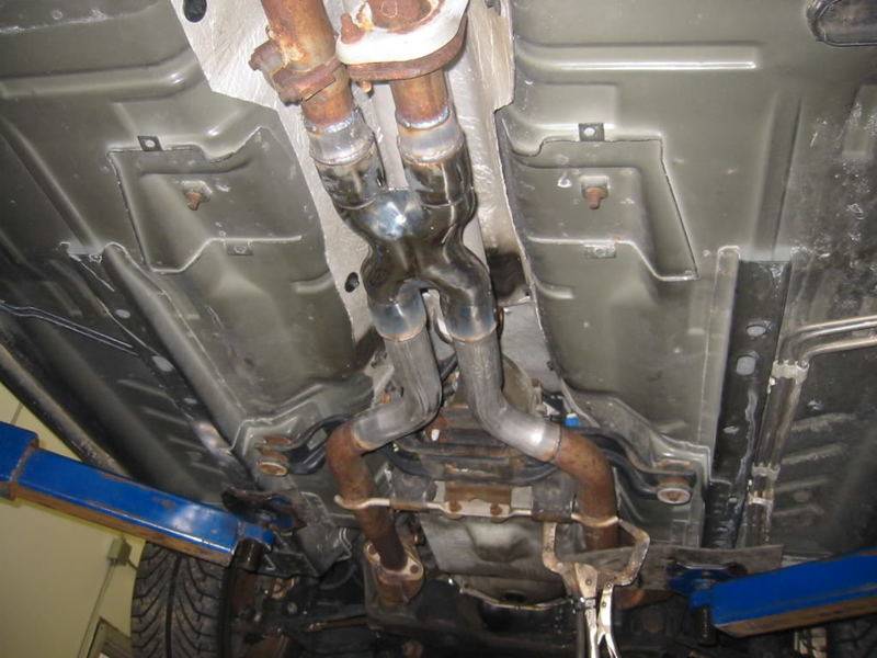

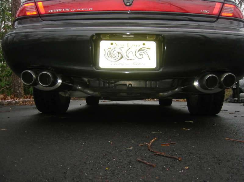

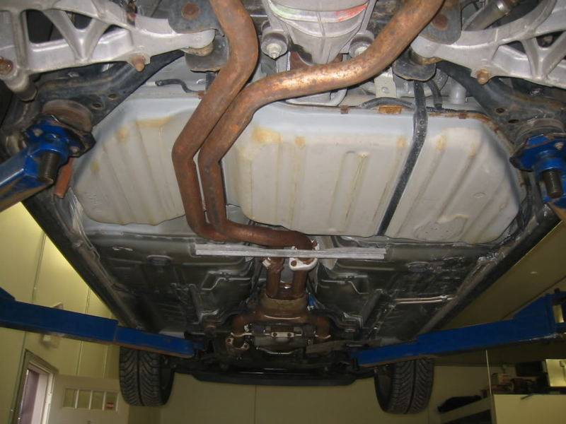

I'll be parting out the LSC starting tomorrow and i plan on keeping the LSC exhaust for my base model. The mufflers are going to be from an 07 Mustang GT. Saw it on youtube and liked the sound and price. It looks like the mufflers are gonna be $50-75. How hard is it to remove the "resonator" and put in an x-pipe or straight pipes? Is there really any difference between the 2? Any opinions on the set up?

There is no resonator on a LSC exhaust, you remove the 3rd cat. Base model has a resonator. Its easy for places that do it everyday such as a muffler shop. Dont bother with straight pipes at this location, you want an x to balance exhaust flow.

I always thought it was funny when you blur out your liscense plate. Like everyone on he road doesn't see it every day.:p
What did it cost to get that x-pipe and mufflers installed on yours? (if you don't mind my asking)
