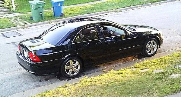

Yes thats my car in the pic and ive been a mechanic and worked on cars most of my life but I'm not a auto trans expert. Yes the trans comes out pretty easily and I have a garage but I was hoping to be able to just have it fixed for $500 and under. I could swap the solenoid pack myself no problem but I'd rather not remove the valve body. Too many check balls to fall out and go bouncing across the floor. I bought a scan tool yesterday and I hope I can pull a code for the trans. If not I'd bet its a broken spring or something in the valvebody. I'll look into a rebuild kit and a good shop to do it, but my wife needs the car as bad as I want her out of my Mark VIII and a rebuild would likely be a 2 week+ ordeal. I need to beat the streets and find a local trans guy. There has to be one closer to me than all the way in Dayton
if thats the real car in the picture, its a beautiful car, probably worth the $500.

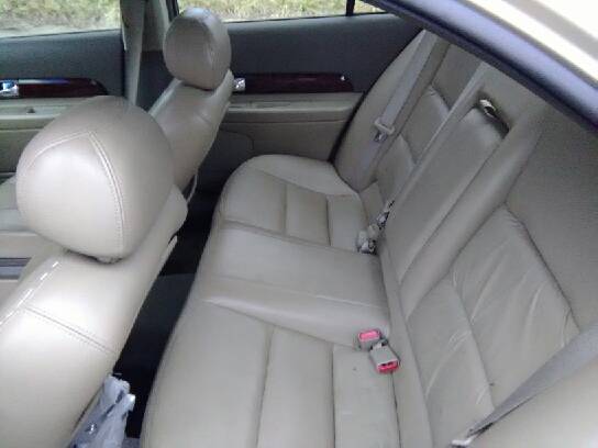

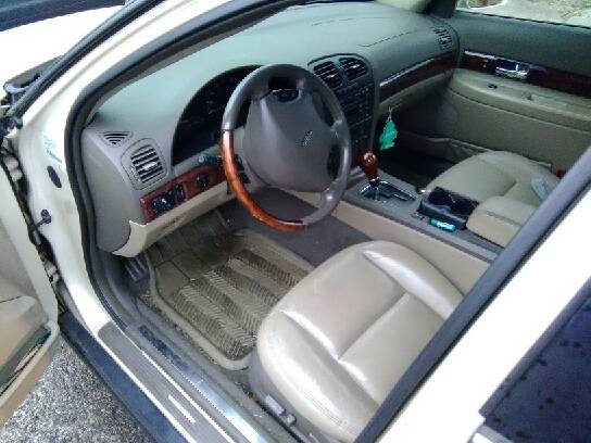

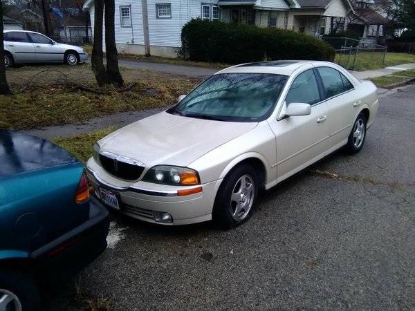

I found a complete 2000 LS with timing chain issues and a good trans for $500. I talked to the lady today and the trans in her car has had the solenoid pack replaced 8k miles ago. She said the trans works fine and she just wants it out of her driveway. The car looks pretty clean and for $500 I dont see how I can go wrong. I have the garage space so a parts car might be the way to go. With a bad motor is there $500 in parts there after I take the trans?
I'll give you the transaxle... but any rwd is pretty much straight forward,,, IMHO. If a person has the experience for the repair. Must have a tranny vice in your shop... to keep the trans vertical,,, without putting any pressure on the tailshaft.
I've been a mechanic most of my life and have worked in several trans shops as a r&r tech but I have no desire to tear into my trans in my home garage. There's a 100 different things that can go wrong and I also have no desire to pull it back out if I get it wrong. I'm going to look at a parts car that has had the trans updated and go from there. It's a warm day here today I'm about to go stick the battery in it and see if it will move. I need to get it in the garage
She just sent pics of the inside and it's cleaner than I was expecting for the money. I think I'll keep that wheel for myself.. lol Anyone need parts??
...With a bad motor is there $500 in parts there after I take the trans...
Possibly, if the interior is in good shape. You might get $150 for the headlights alone. You should be able to get $250+ for the front seats if they are in good condition.
