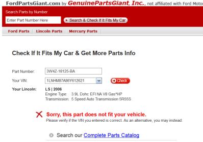

I am ordering my rear toe links here shortly and I need some other stuff too before I put my eibachs on, like front and rear shocks. I read all kinds of threads on it and it seems part numbers have changed, some people say you need this others say something else. Some say you need the camber kit, others say you don't. It's really just a cluster of information and only a few times did the OP actually come back to a thread and confirm everything went okay.
So can the elders here confirm what all I need. Like part numbers and such.
Front and rear sport shocks, new part numbers and best place to buy? Eibach camber kit, is it needed?

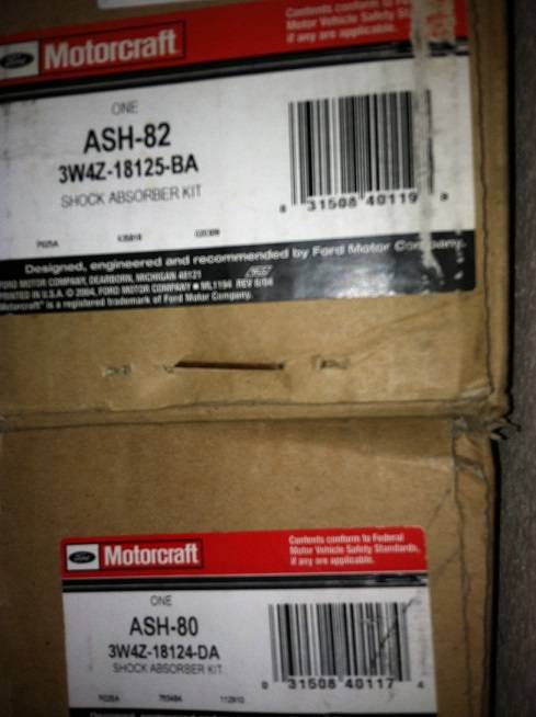

Here are part numbers......
ASH80........ ASH82........ AST214..........AST216.......ASH355.......ASH356
Or.....3W4Z-18125-BA......3W4Z18124-DA. Pics taken from the set I have in the garage. I don't remember which is front and rear....
