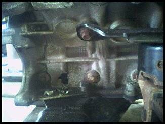

oh and here was the problem with the olf engine
