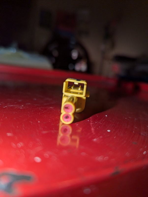

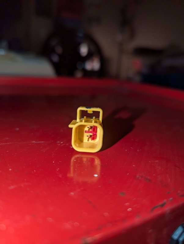

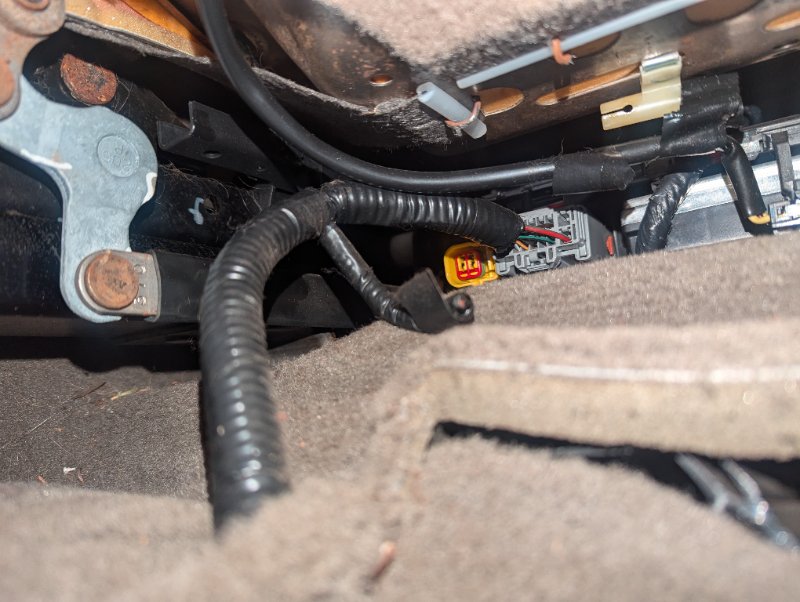

Hello all, I am looking for identification of this connector/module under the driver seat.
Since I got the car (2000 Lincoln 3.9) the airbag has been illuminated. I replaced the clock spring recently, which allowed the previously nonfunctioning horn to function, but still no cruise control and airbag illumination. Forscan tells me the rcm has a code for side airbag(driver) open circuit. I have read that some people have had issues with connections under the driver seat. I took a look and found a 2 wire connector broken off going into a module type thing. Does anyone know if this could be the airbag module or is it unrelated? Thanks for your help. Christian
