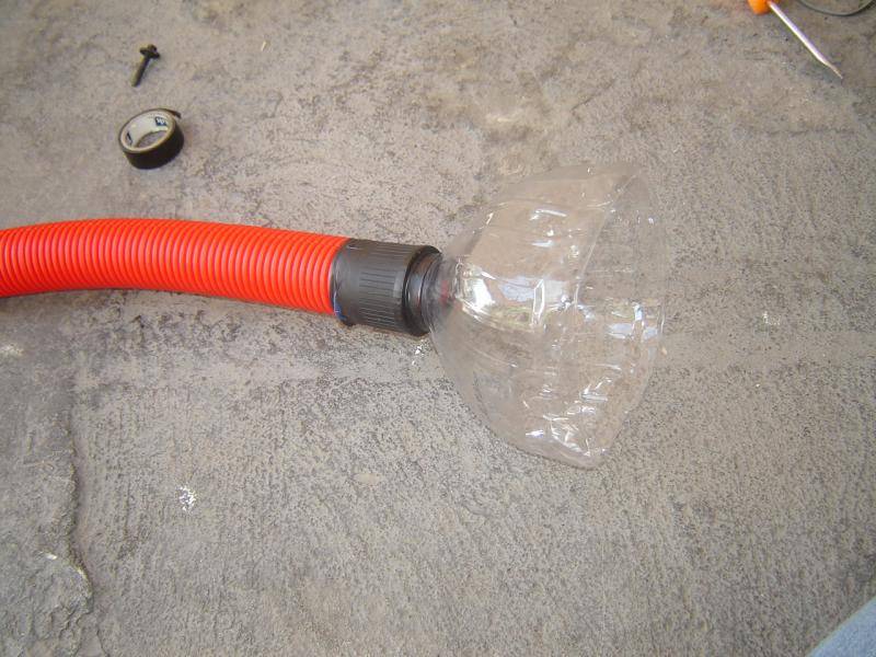

dNyce LS, the mesh grill is a great idea. today im going to test it, install my prototype and see how it works. ill let you know, thanks for the idea. i used a big bottle top to make it like a funner after a little research funnel would be the most aerodynamic and best shape.
but i hope it doesnt make too much noise.

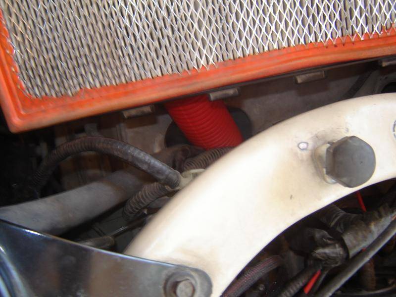

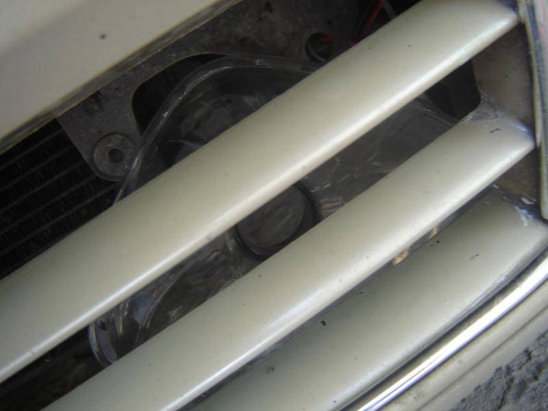

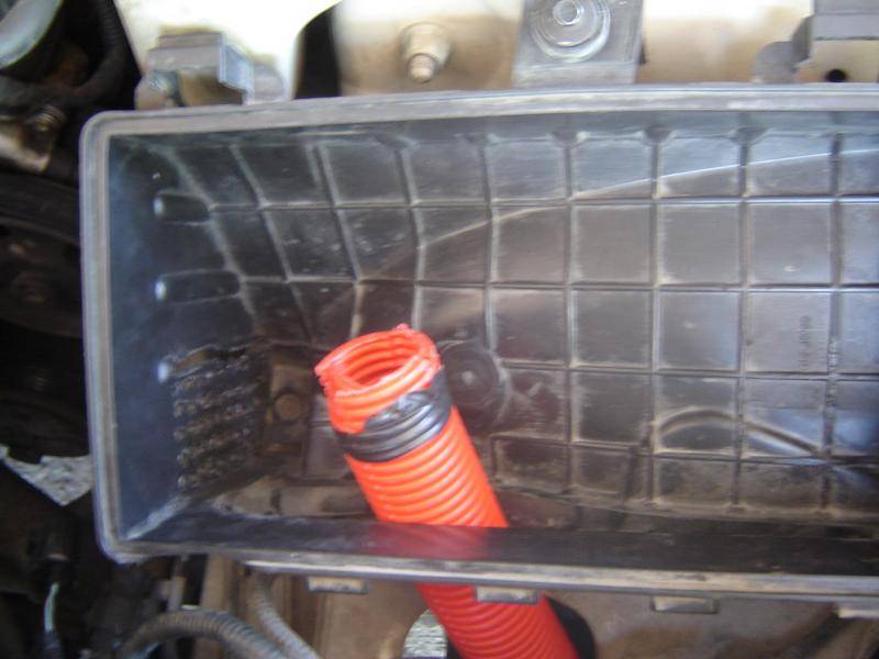

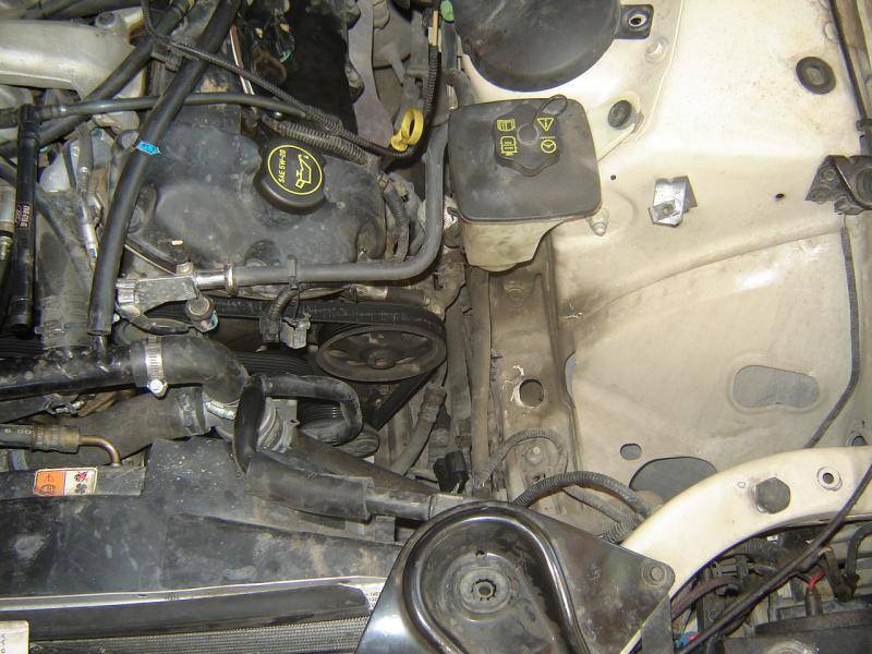

I used 3'' pvc pipes, wanted 4 but was too big. It fits, you just have to cut that little angled flap to the pipe can cross into the lower grille. I used the stock air box, seem better than what I would've used before, plus it was rectangular and fit real good in the lower grille.You have the right idea but just re-think the material. The 5 liter top was good especially since it has a smooth funnel. Just use better piping. You wont notice any benefits from take off obviously, but while driving on the freeway and making the car down shift, it was more responsive, enough to feel. Not enough to say I need it and can't imaging myself without it, since i haven't put it back on after installing the lse bumper, but it was a cool experiment and got small, small gains from it. Here are some pics.
Oh and I also had to cut the opening below the intake and make it bigger for the pipe to fit, but it all fits good.If you look through the hole in the last pic, you can see a part of the wheel well plastic I trimmed for the pipe to go through.
