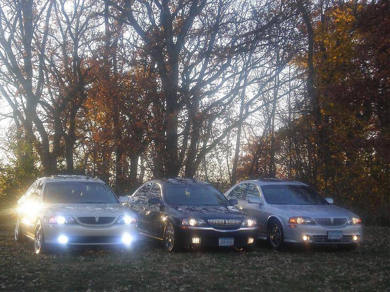

My color temp is 6000K. I have a set in both low beams and fog lights. Here's a picture of them on. Mine is the one on the far left:

wow those are tight, 6000k doesnt look bad, thanx.

You definitely have the best one of the three in my book. It doesn't mean I like you though.

That pic makes my car's lights look the worst Pete :( and it reminded me of my fog light incident a few months back.... :(

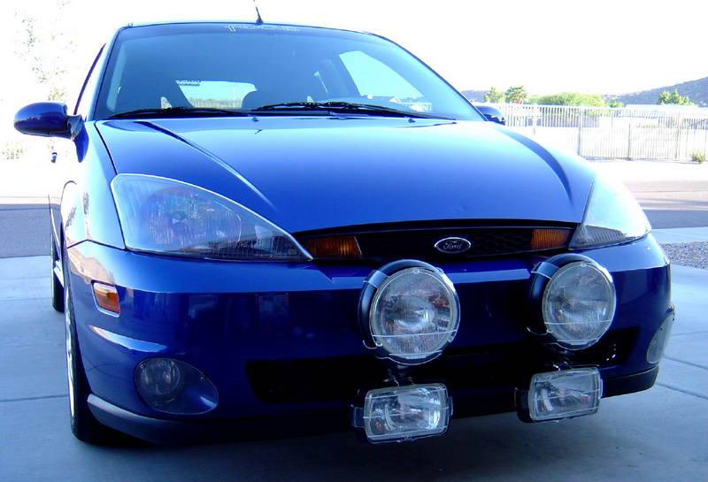

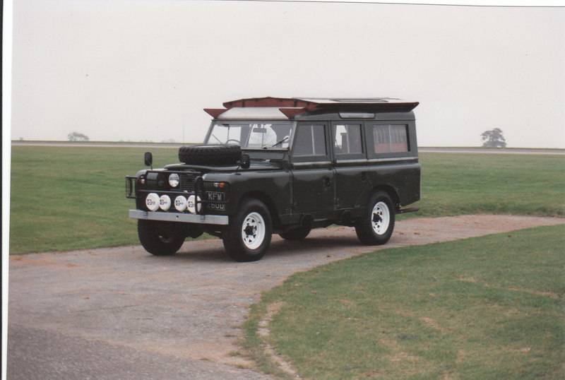

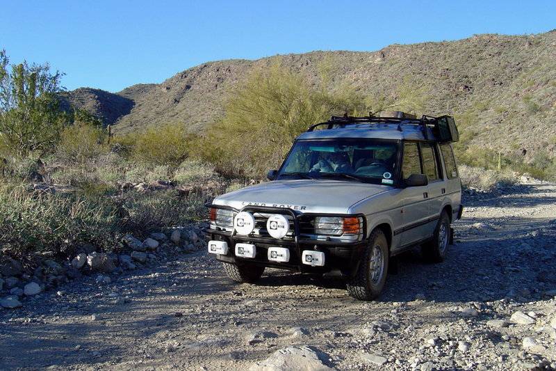

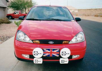

You don't need HID's. Replace the low beams with H9's, which install with little modification (I seem to recall having to trim one of the little tabs, they fit fine and have worked perfect for over a year in my LS and I drive after dark A LOT). Raises the low beam output from around 1200 lumens to over 2000. High beams can also be upgraded to HIR1's (check them out at http://store.candlepower.com/9011.html) the 1700 lumen 9005's can be replaced with 9011 HIR1's, which have over 2500 lumens (a 49% increase in output for $23ea). I am a light freak and so far have felt no need to add further auxilliary lighting to my LS as the bulb upgrades are pretty good. The little Cibies in the bumper have been upgraded to the H11's that I took out of the headlights, probably increasing that output by over 30% as well.
Some of my other light projects.....
