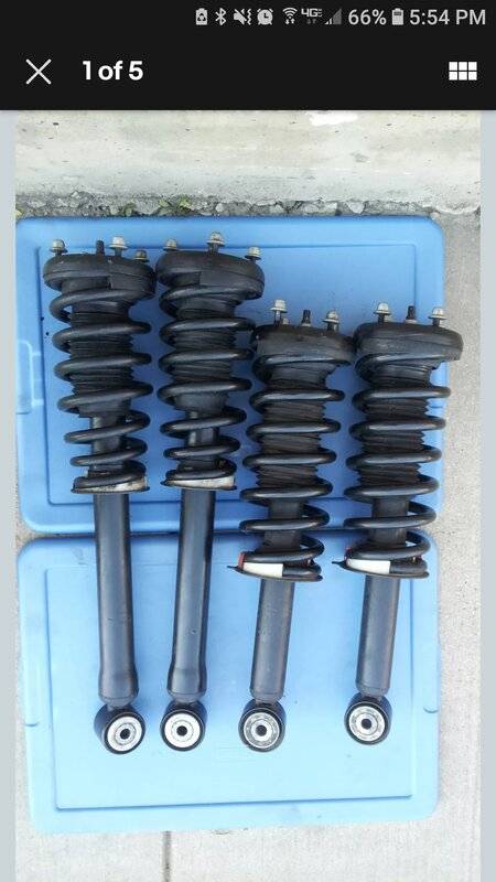

Ebay ...a place in Keller Texas sells gently used all seal coated MotorCraft Shock absorbers mounted complete and even the 4 bolts are in the proper polarity ...easy swap in and out
Keller? That must be the LS guy I bought the rear wing from. I like how they're complete but I'm a little leery of certain parts used though. Struts and shocks are one of them.

Agreed...used parts are always buy at own risk FWIW based on my own personal experience with this company I was very pleased and impressed with there quality
I agree that some things should be bought new...but as we have all found out ..not alwt an option with the ls. The used set of got from an 02 were in amazing shape and are quite nice...only new option I know of that is decent apparently, is the setup you can get from strut masters.

I would like Bilsteins but can you get them in a complete assembly like the used ones in the pic Dutch posted above from that place in Texas?
Not sure, but worth checking out either way. The used parts outta Keller will be cheaper though

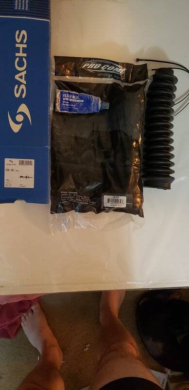

I like Sachs shocks on my 04 LS. Have two to three sets of Monroes. The Monroes were a little to weak for long term. The Sach have a off road boots installed on the shock tube sealed with tie wraps and silicone and the top boot attached to the top bump absorber. The shaft is lubricated by 1 -2 oz. Nanolub engine oil additive. The Sachs shocks been in there around 120k or so with good operation. The rear hydra bushings have Nanolub grease in the them as well when the rear oem set of control arm were replaced also with good long term results.

I myself am going with a good set of used from the guy in Keller, TX. He's giving me a decent deal for 2 complete low mileage excellent condition strut assemblies for the Sport.
