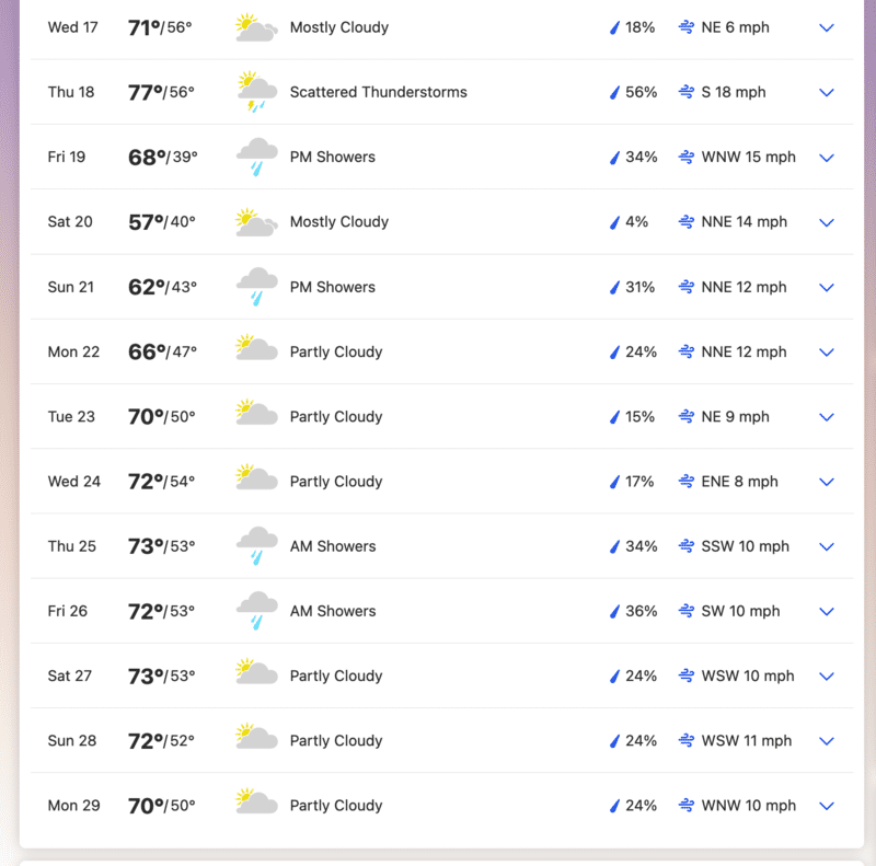

We seem to be jump around here. This is what the next ten days looks like here.
Hickory, NC 10-Day Weather Forecast | Weather Underground
Even better on my side in NC near the beach.
