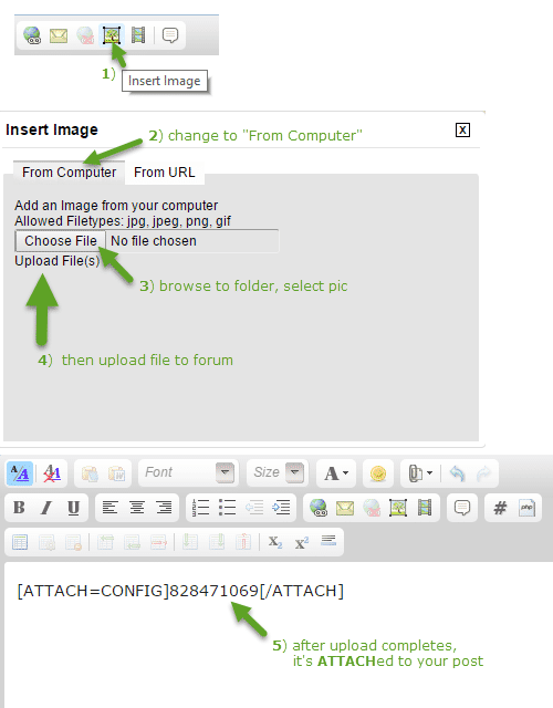

There are more complex options when you are using the "Advanced" posting console. Able to upload
several pics in batch form from your hard drive to forum, as well as being able to remove an attachment (pic)
~ hope that helps.

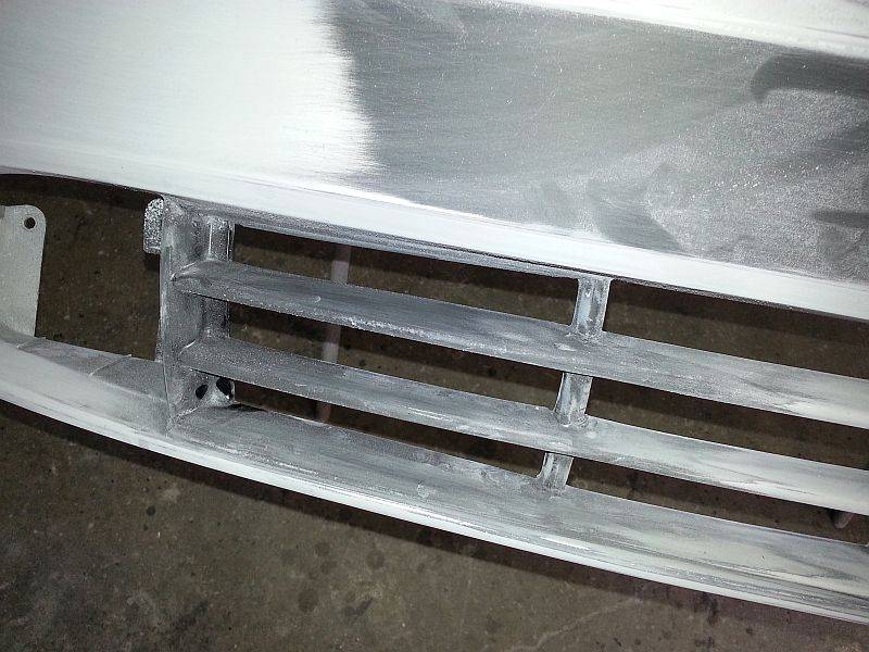

... The missing piece is called a tow hook cover/access door. They are EXTREMELY rare!!!!
and should be molded in when doing front bumper rework,
might not get a tow hook in there but it won't come loose anymore.

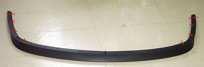

This is a Mach 1 chin spoiler

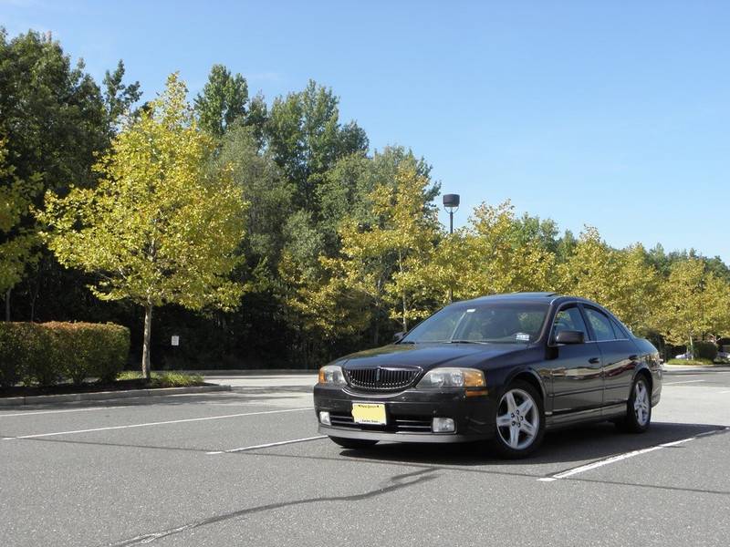

This is an LS with a chin spoiler [mine]

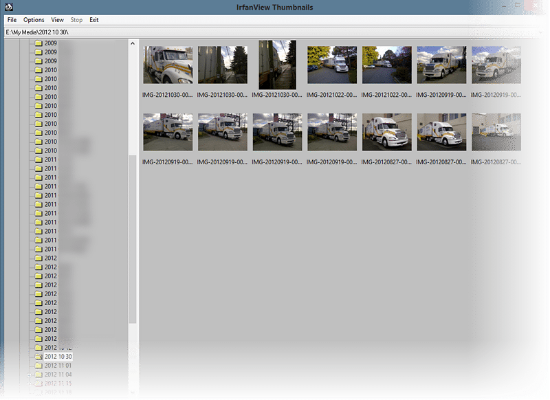

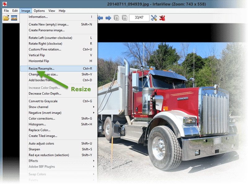

... biggest problem ... is sizing them
Make it easy for you. Program called "IrfanView" @ http://www.irfanview.com/
So simply to use ... comes with a Thumbnail Viewer and Editor.
Use the Thumbnail viewer to browse your folders with pics.
Click the thumbnail to open the pic in the Editor.
- select "Image"
- select "Resize"
new size should be within 800X600 for .JPG extentions on this forum or else it complains "Image too large" when you upload here.
(for larger pics you have to host off site and throw an embedded HREF IMG tag to the pic instead, don't worry about that. Stay 800X600)

... This is an LS with a chin spoiler [mine]
Does look good, might jump back on that bandwagon,
you said you had a way of doing it that retained the undercarriage plastics in it's in tact position, I recall?
LSFrank,
Very nice car, do you need that tow hook access panel?:shifty: As I said nomenclature is important especially if you want it right the first time. The chin spoiler does help the look, and looks like an easy install. Now my brother knows what I'm looking for, he said he'll check where he can.

Basically, take the factory plastic off and mount the chin spoiler to the bumper. I strongly recommend using bolts/washers/nuts+loctite or nylock nuts, as the supplied pushpins from the eBay spoiler weren't long enough. I found the spoiler hanging down in the middle after a 300 mile trip with a triple-digit jaunt or three... oops. Anyway, drill holes through the spoiler and bumper as needed. I have 6 new bolts and I think I used 2 factory bolts.
Next, you say "should I start cutting this brand new part or should I just skip the labor and cut dollar bills into snowflakes?" You fit the factory piece to the bumper (sandwiching the spoiler) and cut into both pieces as needed to get the factory piece to reach the factory bolts. I don't think I used any of the slot tabs; just cut them all off. Sandwiching the spoiler is the only reason it stayed on the car during that trip. Have the bolts go through all 3 pieces where you can.

Thank you. It may not be the exact name, depending on vendor, but it's the right direction. Definitely not a chin spoiler though, haha. I'll trade you the cover for one of those Pep Boys bright annodized aluminum tow hooks... not. I think I did the spoiler in 3 or 4 hours, but I work slow. I have two cars and take my time. I also get sidetracked and start examining other parts to see how they work, how they're put together, etc. A determined person with skills could probably do it in under 2 hours. Less if you just skip the factory piece and use a bunch of zip ties to hold of the splash shield.
Got ya on the "sandwhich'ing" ... makes sense, seen others cut away at the original plastics with brackets to extend and such, looked like a nightmare to get done. May have to look into that next summer, that is a Stang lower lip, I recall. I'll find the details when I'm ready. Thanks!
Mach 1 chin spoiler. Searching for a "lip" will bring you that ez-lip garage door molding (though it doesn't look bad when done right). $45 on eBay, $50-70 on American Muscle. I went with eBay because of the finish. The AM one looked shiny. eBay had both the shiny and the dull versions. The dull version matches the rest of the lower trim, accounting for fading
