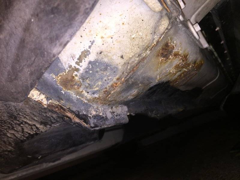

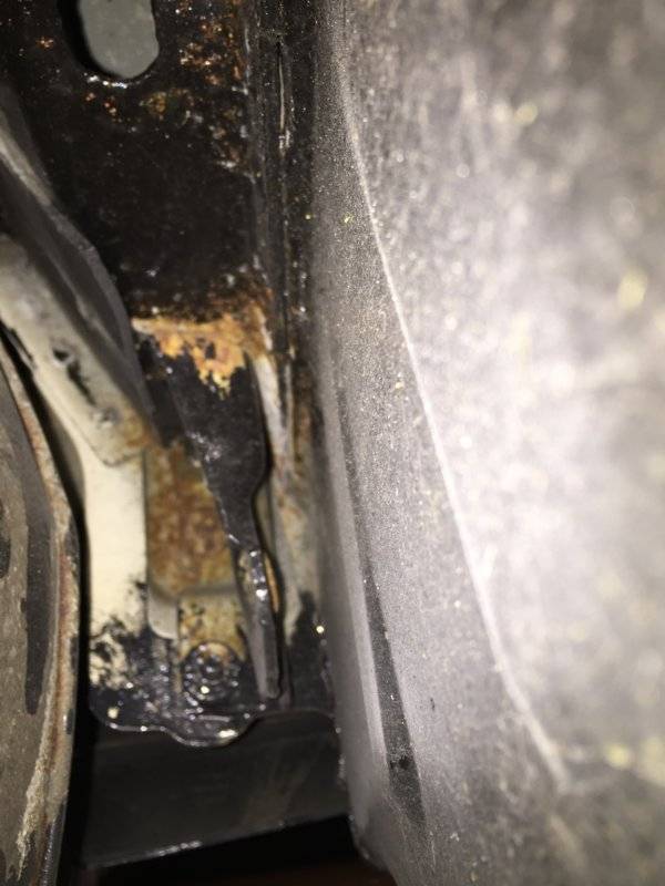

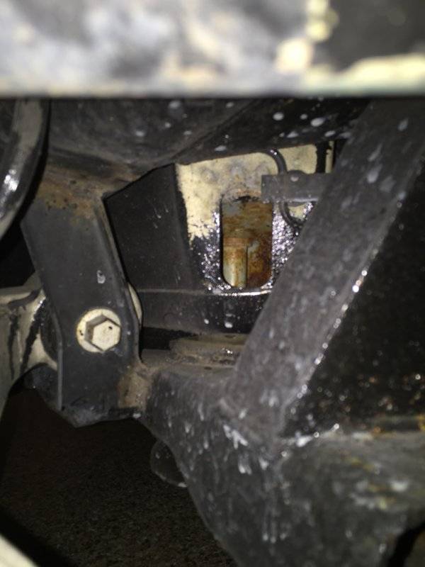

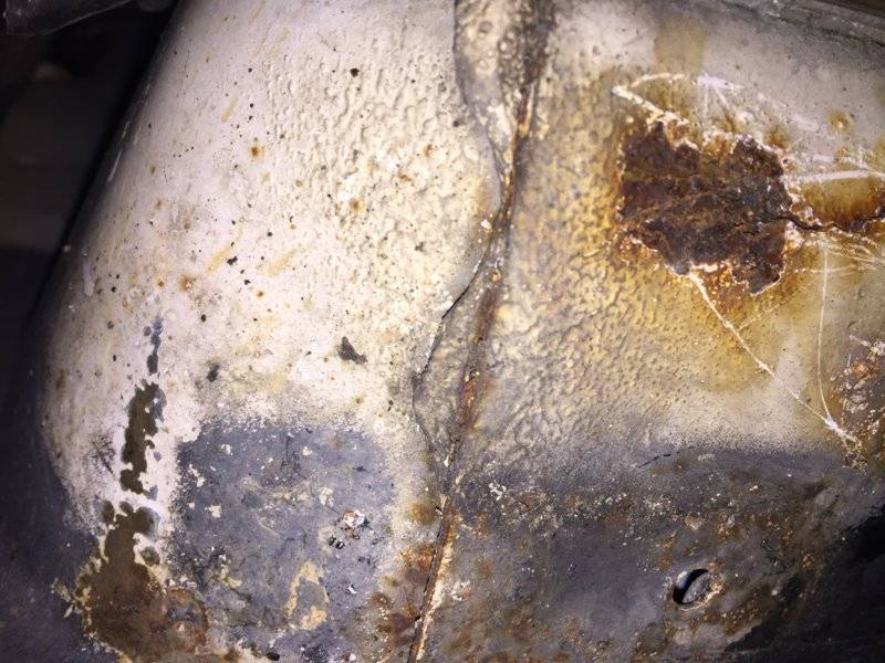

The first picture is looking up into the space between the passenger side rear quarter panel and the trunk wall, from below. The second picture is rust inside a frame rail (perhaps actually just rear rear sub-frame), the third picture is of a bubble in one of the rear wheel housings and the last two pictures are of the driver's side rocker panel.
