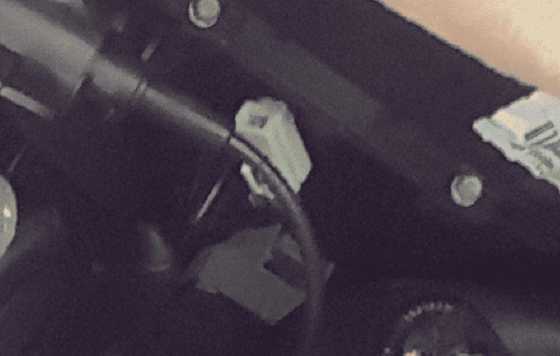

The 2 white plugs I see under the dash do not appear to have anything attached to them. Am I looking in the right spot?

Look a little lower too (may have to pull the carpet back some). I can't tell from the picture, are you positive that nothing is plugged into the top side of the that connector? The bottom side that is showing is correct (a void with nothing plugged in).

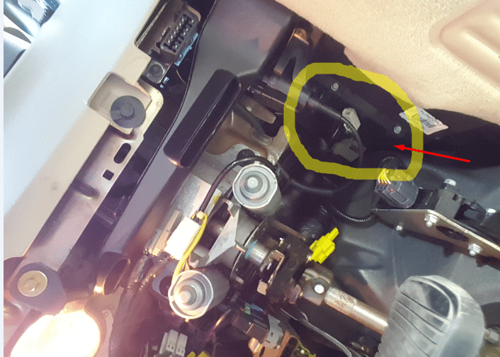

I will take a better look. But here are the 2 plugs from a closer look:
I still can't tell if there is a cable coming out the other end. I think there is. There should be.
Well, we did unplug that sensor and the compressor did not engage. Going to have a shop check the pressures and the system. I need AC, lol
