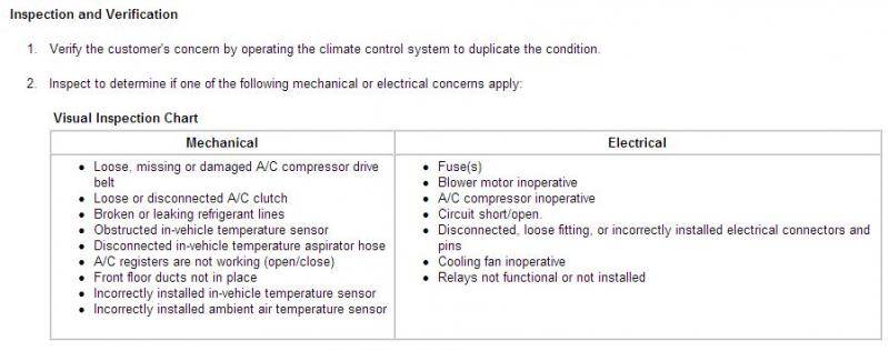

When you say you replaced "most of" your cooling system,
~ did you replace the DCCV with a brand new unit ?
~ Have you run a DATC self test on the console ?
~ Checked fuses ?
- - - - EDIT:
In the front power distribution box, check fuse 01 10Amp A/C Clutch & Relay 08 A/C Clutch
Front Panel DATC Module Self-Test
  • On-demand DTCs are those that are reported by an ECU when a failure is detected while executing a diagnostic test. For the DATC module this means that all faults (hard) that occur while the module is conducting a self-test shall be reported as an on-demand DTC.
  • is entered by pressing the OFF and FLOOR buttons simultaneously and then pressing the AUTO button within two seconds. The display will show counts of 1 to 25 in the center of the display window. Record all DTCs displayed.
  • concludes by reporting all on-demand DTCs. Follow the diagnostics procedure given under ACTION in the DTC index for each DTC given.
  • reports individual on-demand DTCs as four-digit DTCs (less the alpha character).
  • will calibrate all the mode doors and check all analog inputs. The DATC module will only report on-demand (hard) faults that occurred while the DATC module was conducting its self-test.
  • will report individual on-demand DTCs without the °C symbol lit.
To exit the self-test, press any button. This will clear all on-demand codes from the DATC module memory. If no button is pushed DTCs will continue to be displayed.
Upon exit from the self-test the DATC module returns to operational status. The DATC module executes a hard (cold boot) reset which places the DATC system in the OFF mode.
Always exit the self-test before powering the system down (system turned OFF).
Any DTCs (codes) displayed ?
other items to check:
