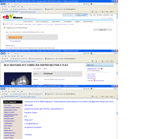

just bought this one this morning. I couldnt buy the parts this cheap.
