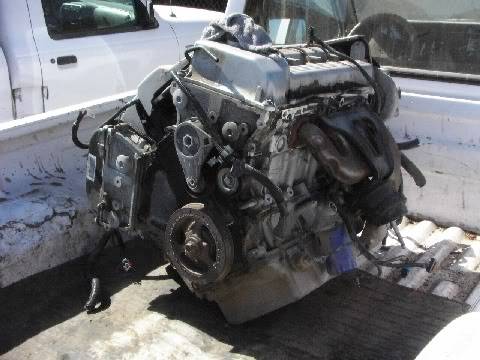

Old Engine:

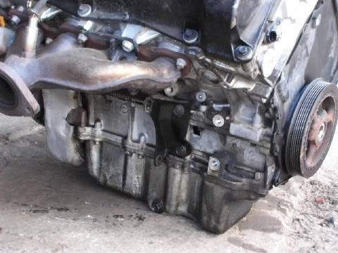

Ahh...A hole. This happened because I decided to drive it to the shop instead of get another tow:

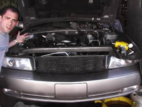

Hey, where's my engine?
Just a transmission, nothing more. haha

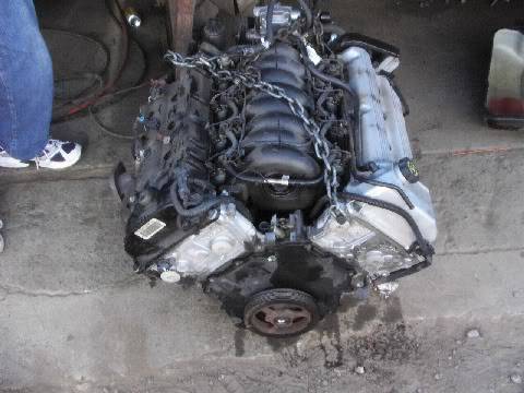

The replacement:
