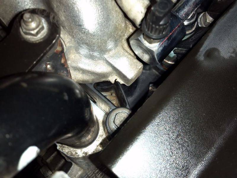

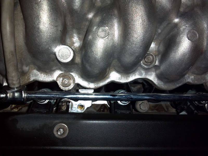

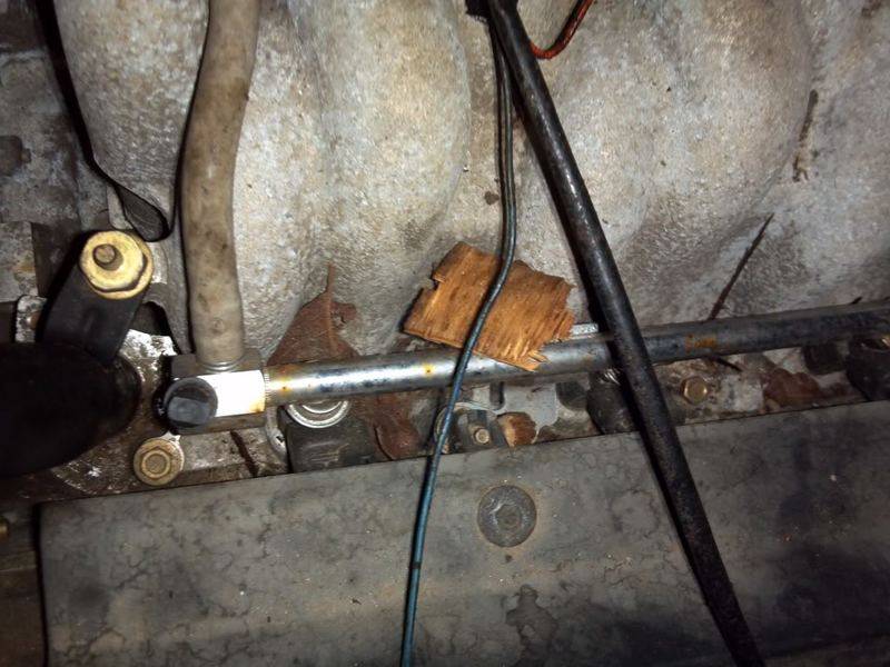

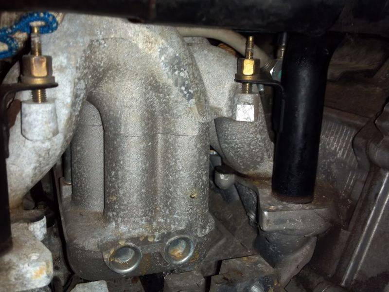

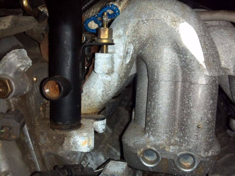

i having a problem with my 98 continental. it started with a misfire, i tried to cure it with new plugs ( motorcraft- gapped correctly) no help. checked all the boots on the coils. there only 2 years old. coils seem to be fine. wiring seems to be fine. so i figured maybe an intake leak, i take everything apart to replace all the gaskets (upper/lower/throttle body/egr) since it was about that time anyway (154K) i get it back together and it runs like hell, turns out the harbor-freight torque wrench i was using was wayyyyy off.so i loosen everything back up and do it again with a in-spec torque wrench. and it runs flawlessly....until it warms up. then back to misfiring and now the new symptom of idling high. i took it apart again to see if anything went wrong when i was re assembling and everything was fine. clean and ready for a good seal. so i get back together with no change in problems. its leaking right where the lower intake manifold runner control is, on both sides. i found this using some throttle body cleaner sprayed on while it was running. theres no reason why it shouldnt be sealed correctly, its at the correct torque spec and brand new gaskets with clean surfaces. its a 1998 and apparently had a plastic lower intake manifold, with the intake runner control. i looked at a 01 continental motor and it didnt have any lower intake manifold and didnt appear to have any intake runner control. im wondering if i can just use an 01 intake an bypass all the plastic lower intake crap. suggestions?

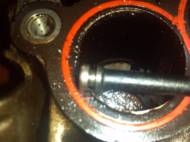

If the leak on yours is where the IMRC rod exits the manifold you might be able to repair yours with just new o-rings. Tried to find a how-to article but no luck on that yet. There has to be one out there.

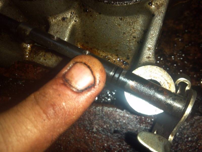

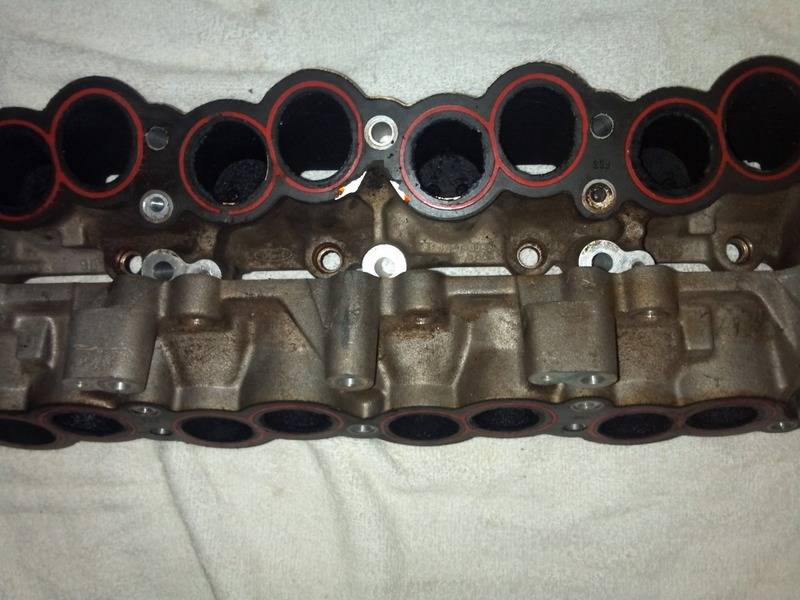

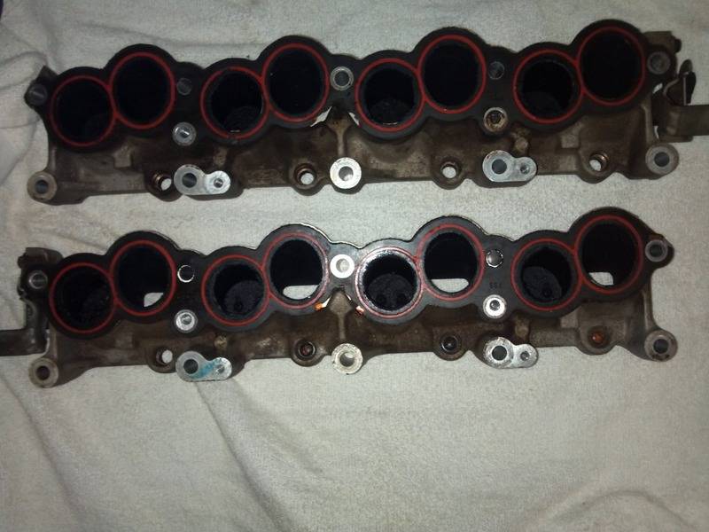

thanks, i actually pulled a lower set from a 96 conti today that where aluminum. and exact same as my 98. i actually installed them on a 98 in yard and they are a perfect match. i went ahead and bought them, and the different style gaskets. but since i never want to deal with this again i do want to replace the o-ring where the rod exits the plenum. on the new lowers. im just not sure how to get it apart.
well after a while of cleaning prepping and disassembling, i got the new lowers ready for new o-rings, then to get them ready for the car. they are so small its crazy how it makes so much of a difference. so i'll be installing the new o-rings in the new (older style) manifold. and install everything tomorrow. hope everything goes well. anybody happen to know what torque spec the intake bolts are for a 96? since i will have 96 lower and all 96 style gaskets.

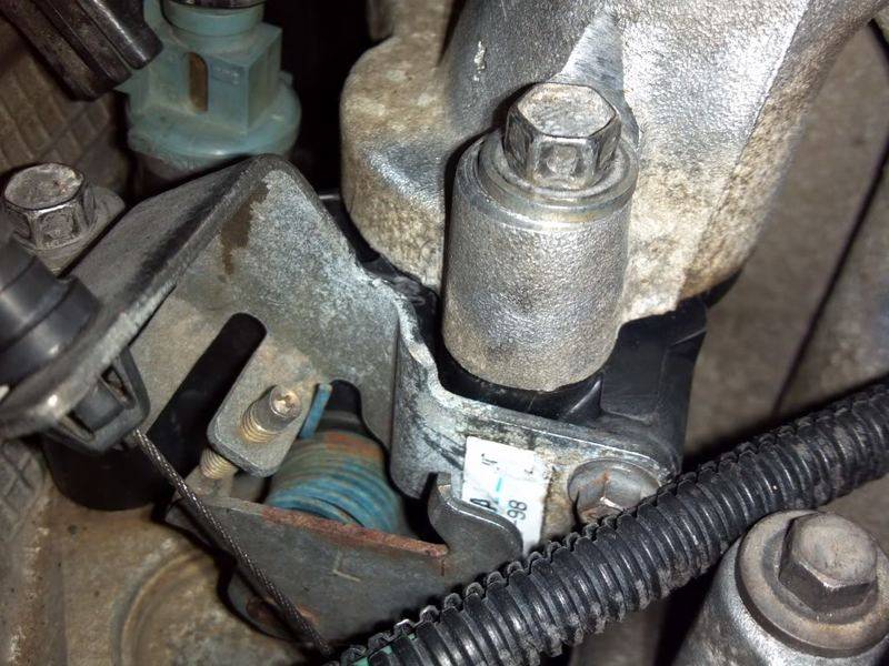

Well got it back together and it's got a leak where the rod for the runner control exits, on the alternator side. It must not have seated correctly. Im wondering if the bearing itself is causing the air leak somehow. But it runs for now, had no issues with using the older style manifolds. Ill tear into it sometime again when i feel like messing with it.
