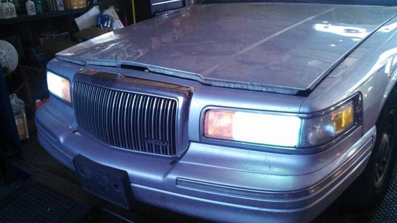

Jan 18, 2014 #1 Murdered_LS8 Well-Known LVC Member Joined Aug 11, 2013 Messages 207 Reaction score 4 Location Northeast MS I purchased the hi/lo kit for a customer and co worker of mine and installed resistors but its still "locked" on hi beam and the halogen won't illuminate. Low beams work great...

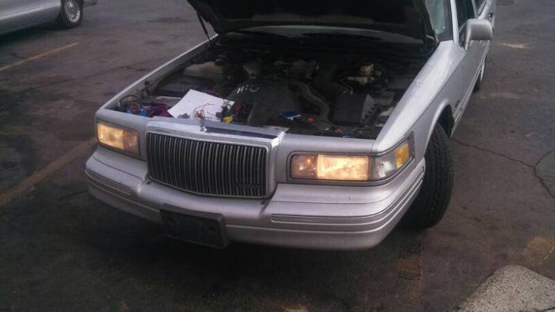

Jan 19, 2014 #2 Murdered_LS8 Well-Known LVC Member Joined Aug 11, 2013 Messages 207 Reaction score 4 Location Northeast MS Got it figured out, had to Repin the plug for 9007 as it was set up for 9004
Jan 20, 2014 #3 slowmkviii Dedicated LVC Member Joined Sep 28, 2007 Messages 5,747 Reaction score 178 Location Elk River, MN Good Thanks for posting the solution.
Jan 20, 2014 #4 Murdered_LS8 Well-Known LVC Member Joined Aug 11, 2013 Messages 207 Reaction score 4 Location Northeast MS They turned out really well. It needs relays, or resistors, because switching from lo to hi, the entire dash flickers...
