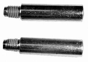

The rubber the pin passes through is open on the end, and they aren't very long or complicated:
Seems unlikly both brakes would be affected simultaneously due to suction in a pin's bore.

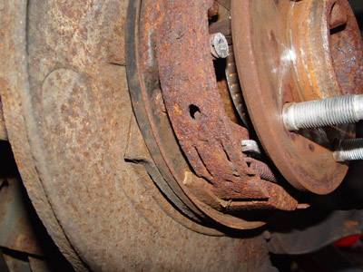

The E-Brake is completely non functional:

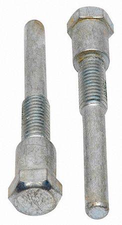

Edit: Hold on, the fronts are more complicated and the end is sealed I think:
