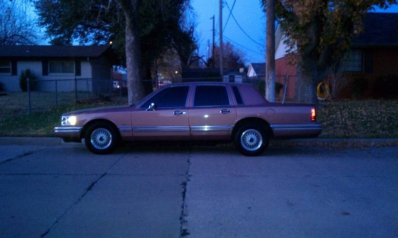

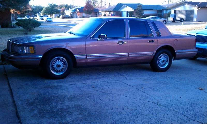

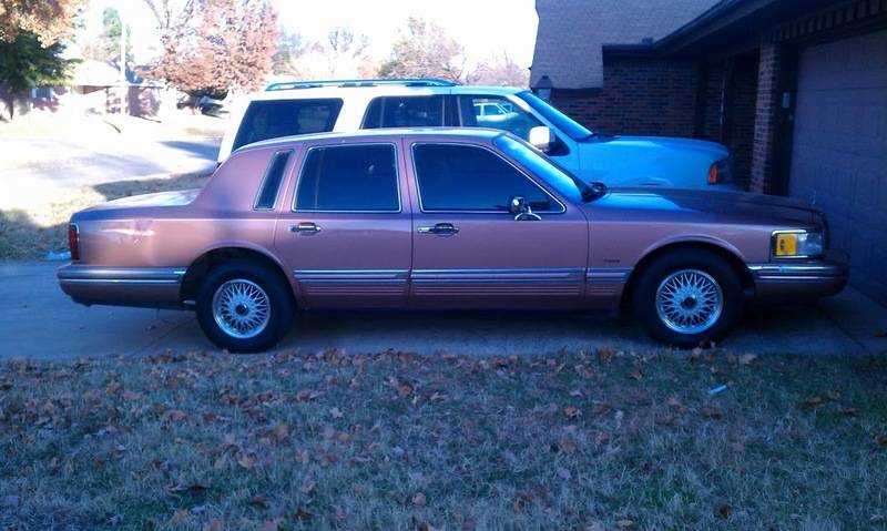

Here's the hotrod. I am liking the spring compressor route because I don't really want to throw any more money at this thing

93 Linc, are the pictures with or without the sand installed? If it is with no sand the ride height looks normal to me.
Its no sand. The driveway is steep too, I'll take a pic of it on the flat street.

Ride height looks good on that car. i have seen them with there asses on the ground and up in the air. I like the way it looks as it is.
