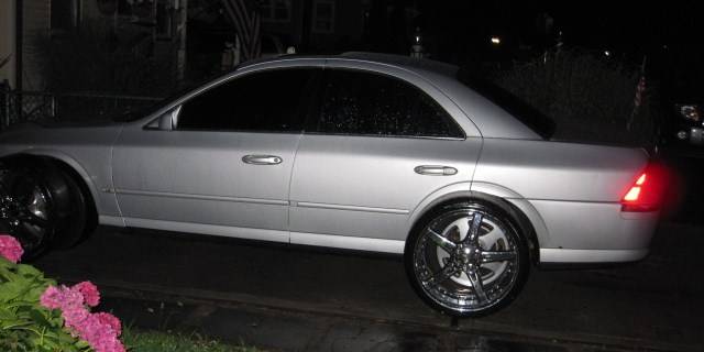

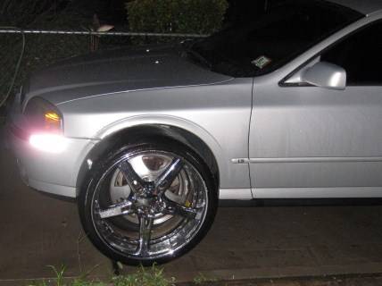

I got a good deal on these 22's. They were free so I couldn't pass them up, But not really sure I wanna put them on. Anyone ever run 22's on there Ls any problems with rubbing? And they definately look like they need the fender rolled to fit.

That's a nice looking wheel but I'm pretty sure you'll have some rubbing issues. What's the bolt pattern?
They are 5 x 108 and not sure of the offset. They came off of a Jag. They are Maya Mrs Rims.
They look hot. As in stolen. 22's for free? sounds fishy to me.
Put them on, see how they look. What size tires?

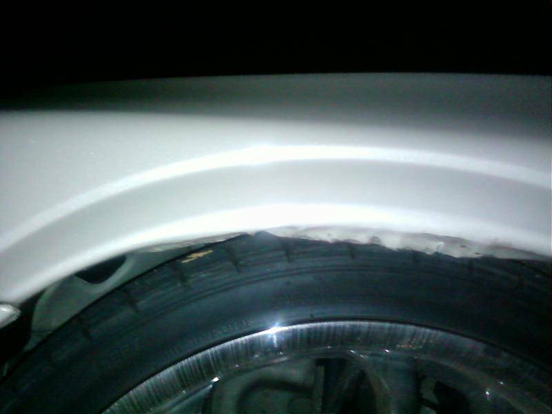

I was wondering why they looked so effed up, then I realized they were just sitting next to your car.. I rub with my 20x7's even before I lowered it and the front has completely tore up my fenders so if you do it, roll the piss outta those fenders.. Other than that its been done before so I dont see any issues other than it being an SUV
stock diameter is about 26.25".if you have 235/20 tires on there, your total diameter would be 26.68". So that way would work, but you'd have to have correct offset too.
Well they do need new tires all they around so the tire size can be changed but the rear rims are 10.5 inches wide, maybe a little to wide. And they werent stolen lol.

This is what happened to me with 20's, granted Im lowered but still, 22's will have the same effect
