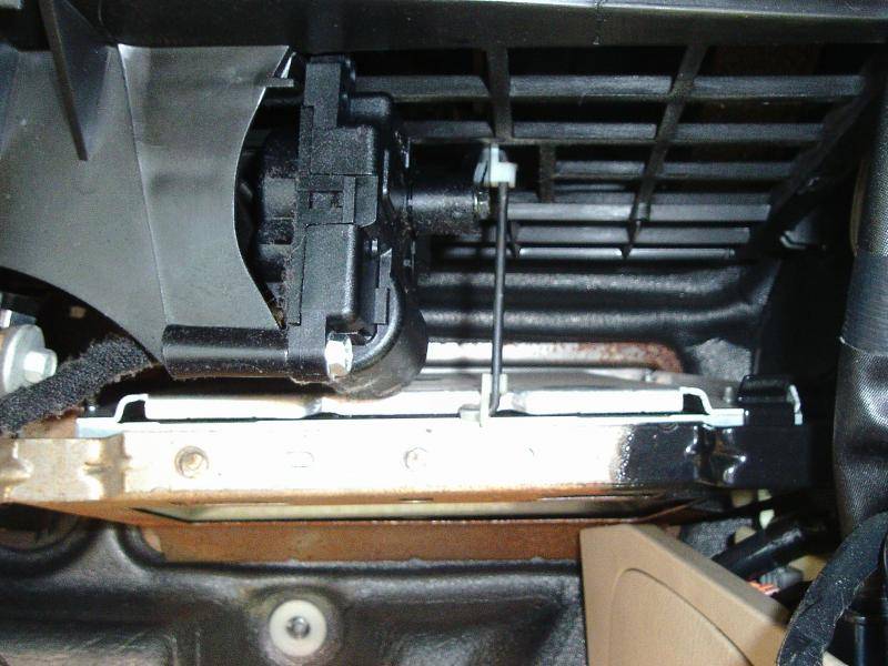

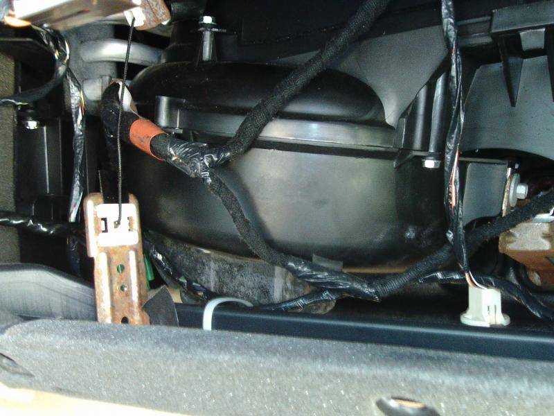

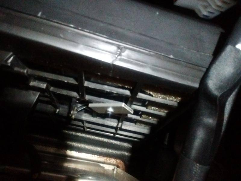

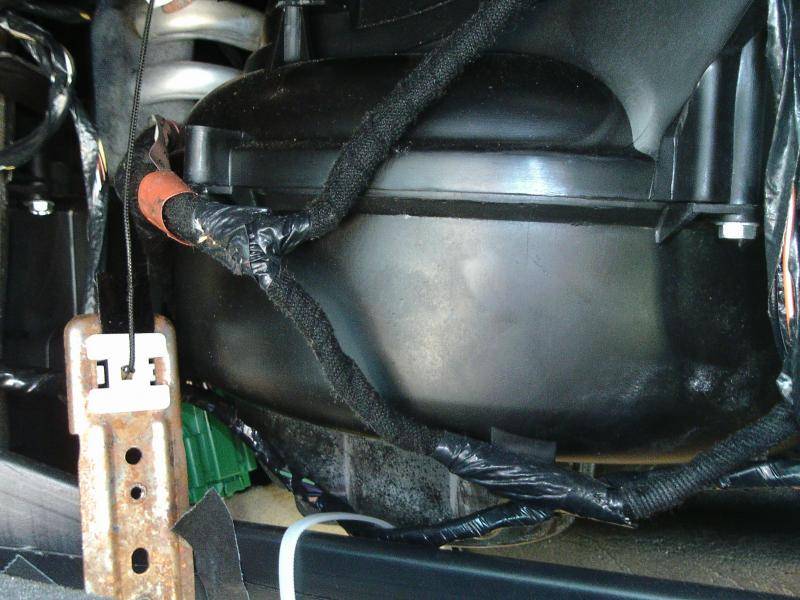

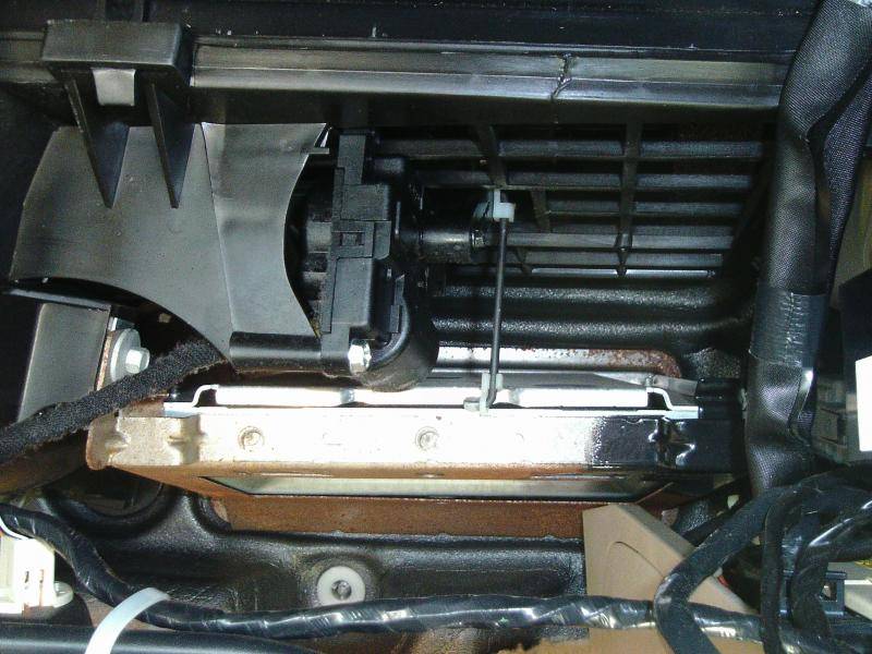

So I just finished removing the glove box on my 06' and I believe I have found the culprit to the noise I mentioned in an earlier thread. One member mentioned it to be something called the "recycle door/fresh air actuator" or something of that nature. Basically, I hear a hollow wobbling sound whenever I shut the doors, and all windows are up. I closed the doors and felt around and I could feel the vibration coming from the large black cylinder pictured below. It appears as though the entire dash would need to be removed to replace. Is this accurate? What is this thing and is it easy to fix? Also I noticed that the cable for the glove box door is just dangling, is this normal? Last two pictures were a latch I found just flapping around. I'm imagining it was connected to something at one point, I just don't know what. Can anyone please provide some input?

So I just got off the phone with my friend. He says its the arm in the last two pictures needs to be connected to a door above the grate pictured. So he is saying it is NOT the large black cylinder. I mess with the heat and I can see the actuator arm moving, the rod however is just dangling from the actuator arm.
So it turns out it is actually the flap that went bad. A quick trip to the dealer, the flap isn't a standalone part, its sound as an entire housing assembly. The key here is... It's a discontinued part! I'm going to try junk yards. Does anyone have any ideas?

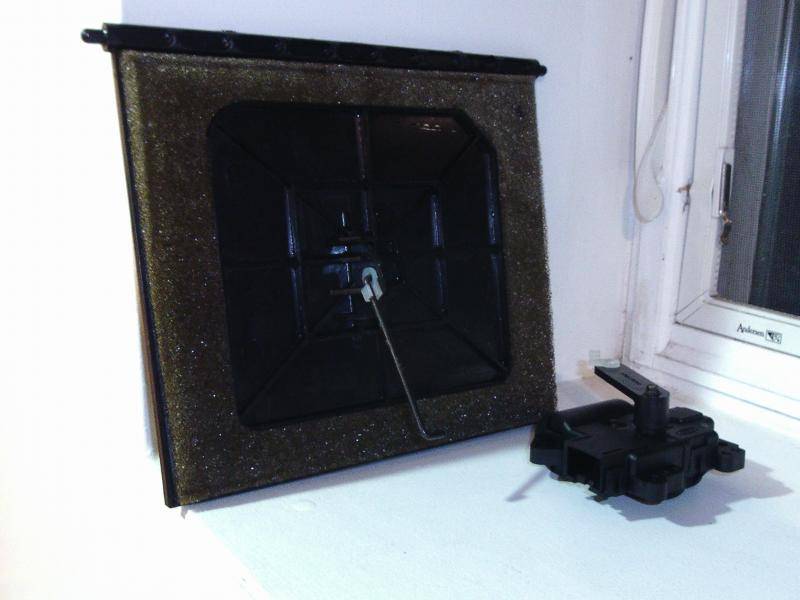

Update - So I got the door out of the HVAC assembly + the motor, 5 bolts (4 around door, 1 near inner blower) and the HVAC assembly splits right in half, giving you enough room to take the door out. Obviously gonna be a hell of a lot harder doing this in the car seeing how there's like no elbow room! Well, at least there's some hope that the whole dash doesn't need to come out!
Here's the new recycle door & motor
Alright ladies and gents, so we've come up with a solution. Now that I have an entire 2005 Lincoln LS HVAC unit to use as a template, we are going to Dremel out the old hinge from the old door and screw in an aluminum hinge to hook the arm into. This should increase strength and longevity as this seems to be a common (and annoying!) failure point of the LS. Stay tuned as I will update this thread this weekend. Happy Thanksgiving Lincoln vs. Cadillac!
