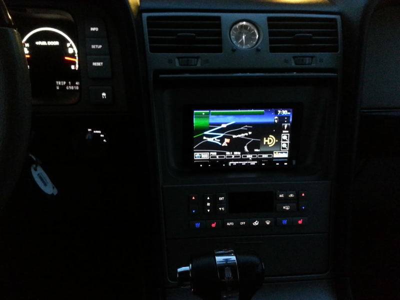

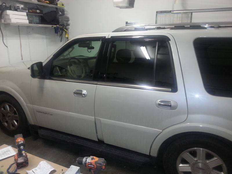

Did an SQ audio build on my friends 2006 Lincoln Navigator that has the THX sound system. Here are the new
products that went in and replaced the oem system.

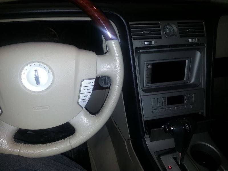

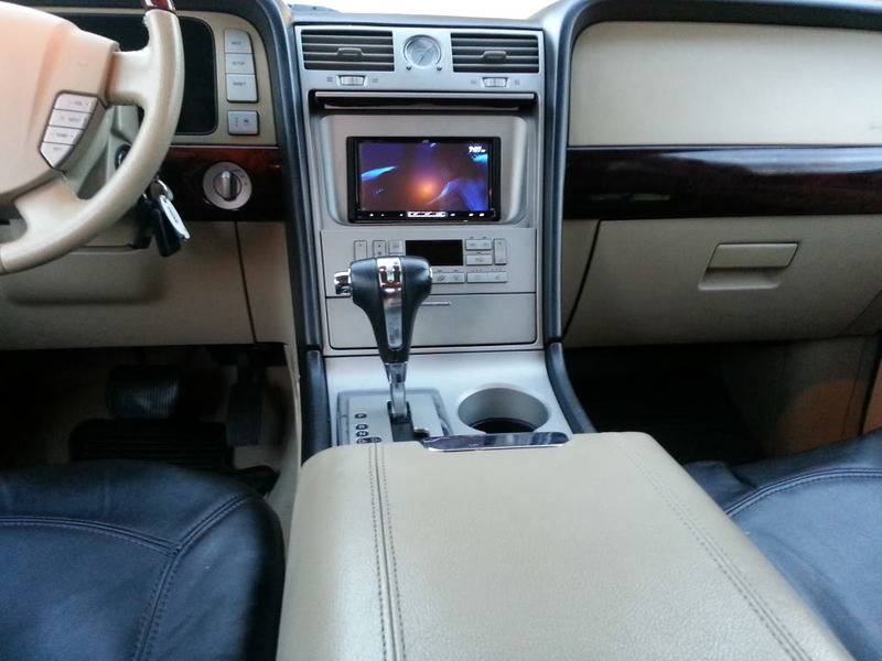

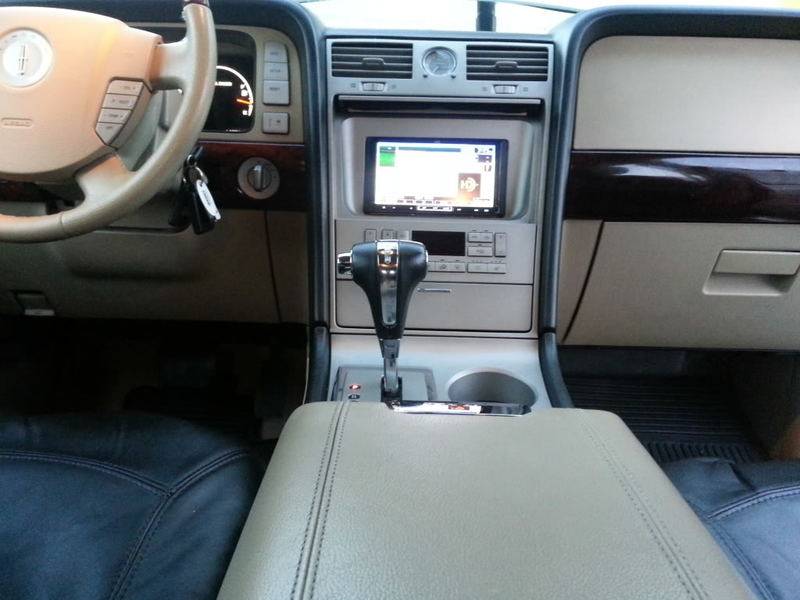

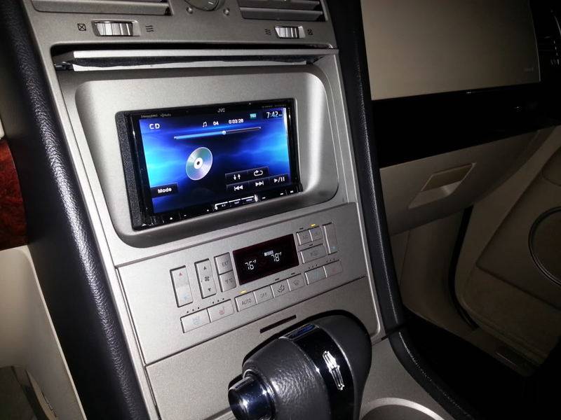

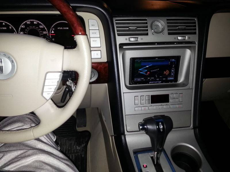

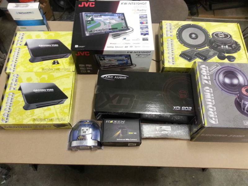

Head unit- JVC-NT810HDT 7" Navigation HDD Unit
rear view camera- Rydeen miny hd camera
Sat Radio- Sirus XM V200
Amplifiers- ground Zero Radioactive GZRA 4.100G and GZRA 1.600D

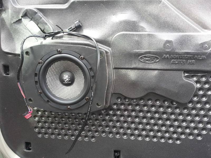

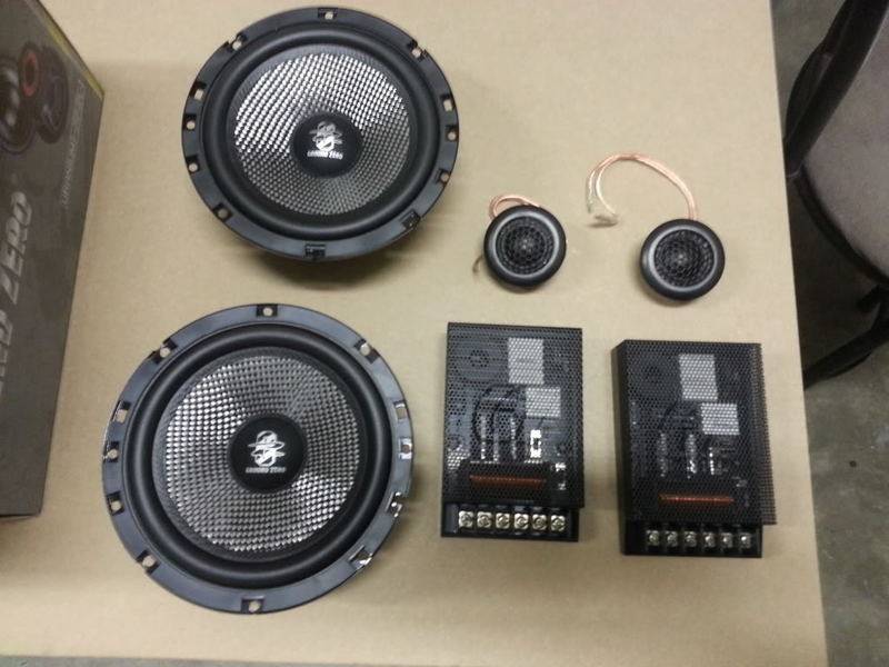

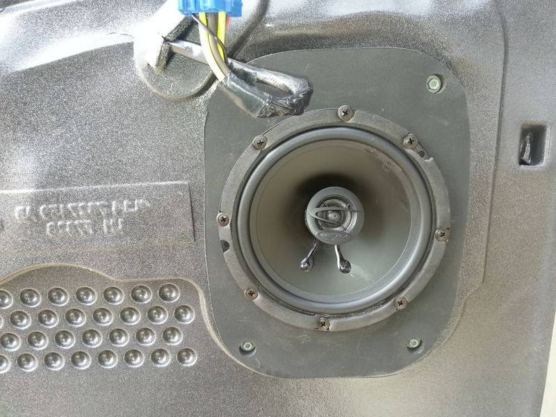

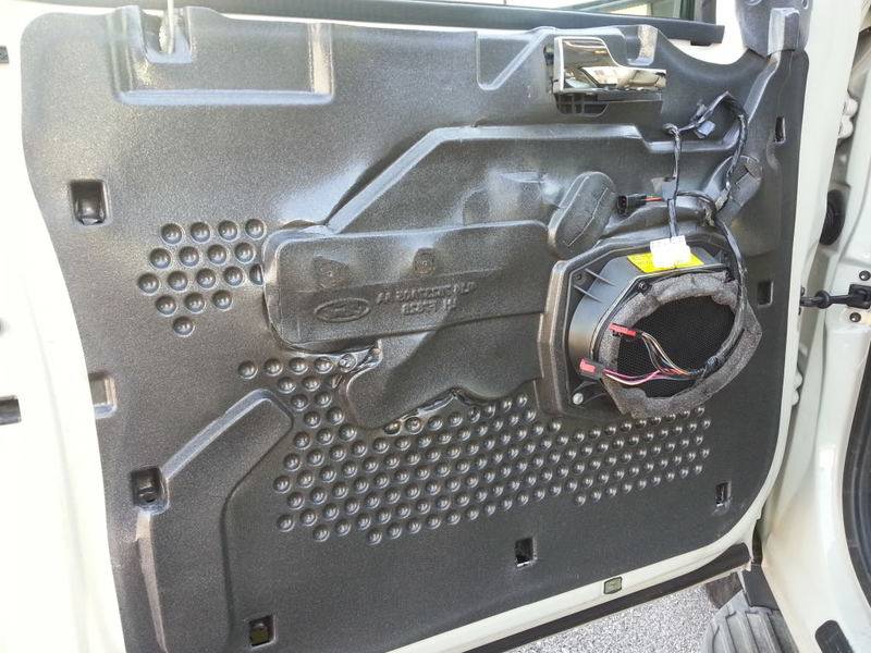

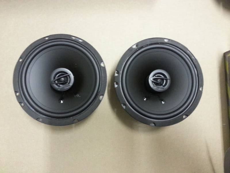

Components- Radioactive GZRC 16Xll 6.5" components

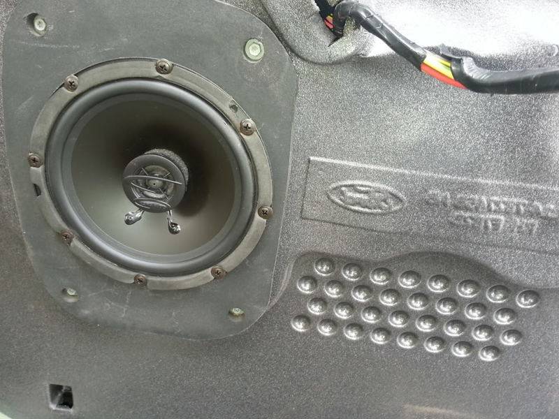

rear speakers- Arc Audio XDi 602 6.5" coax

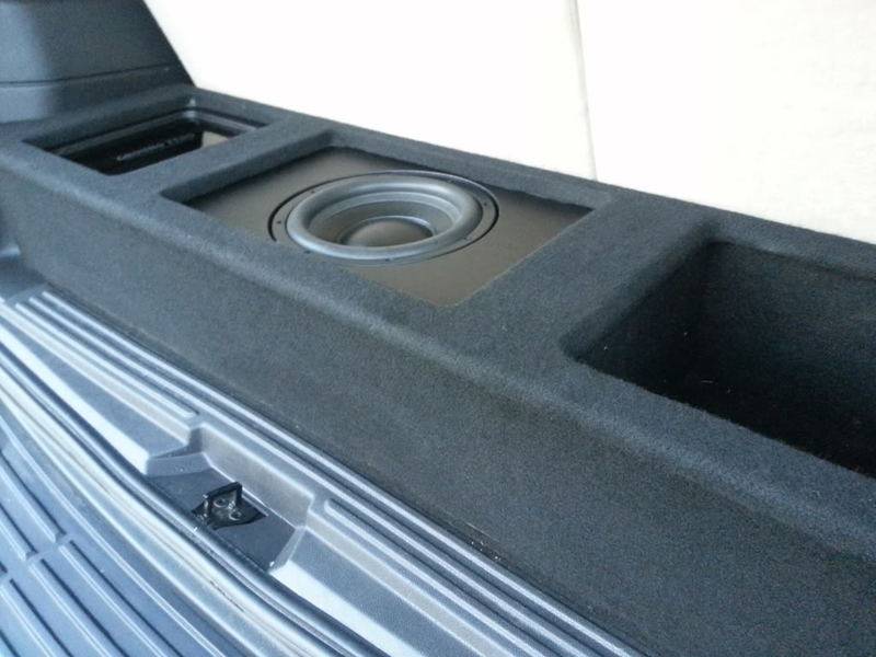

sub - Uranium GZUW 10SQ 10" Sub

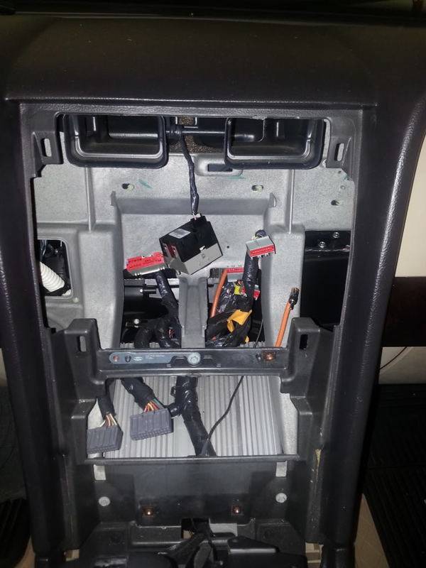

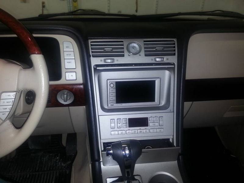

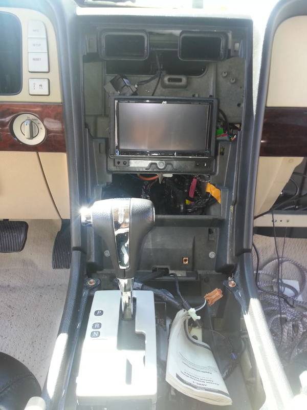

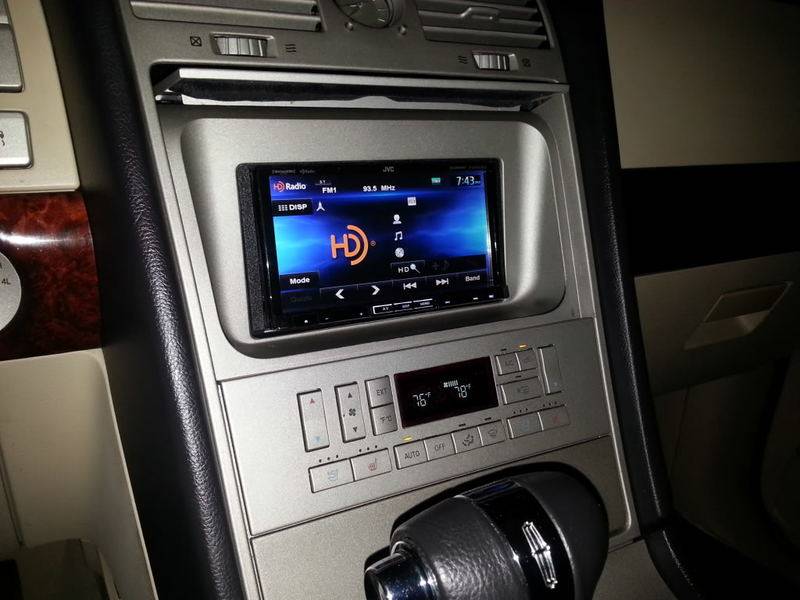

Wiring up the JVC 7" HDD Navigation system, steering wheel control, HD backup camera and Sirus XM radio.

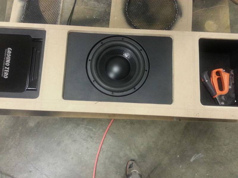

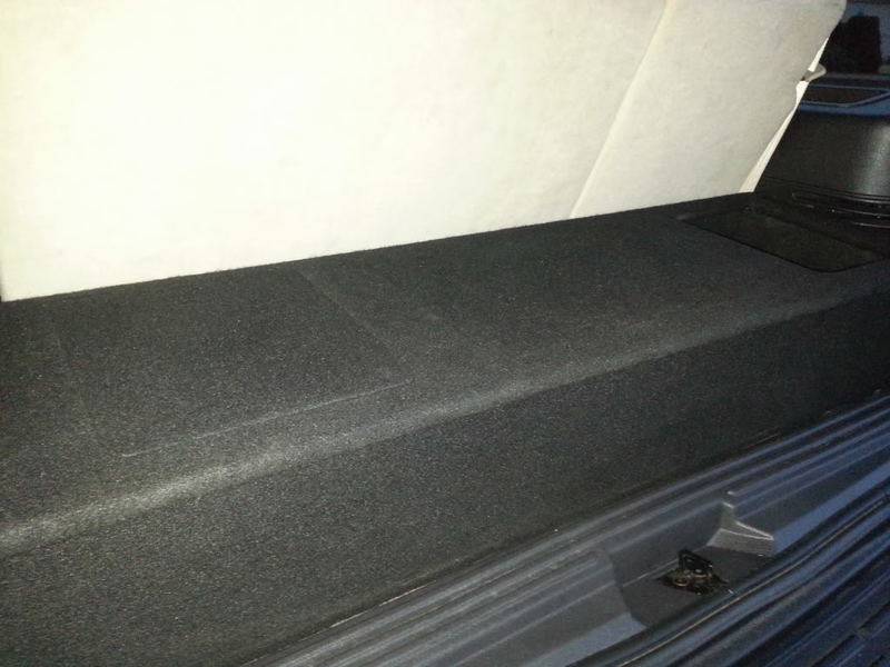

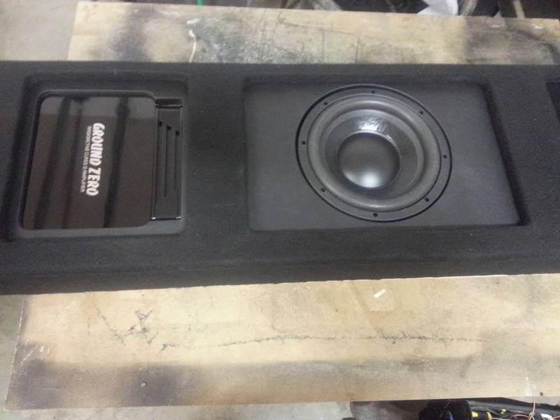

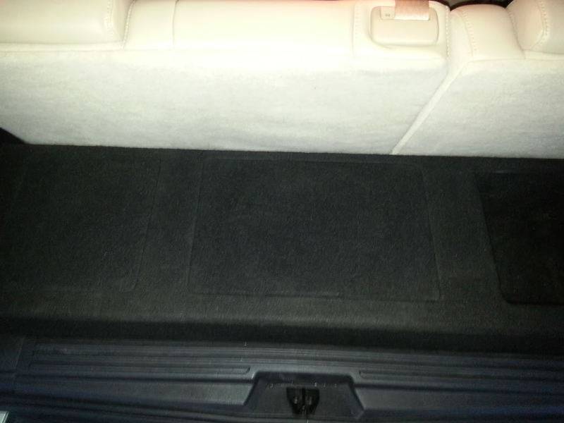

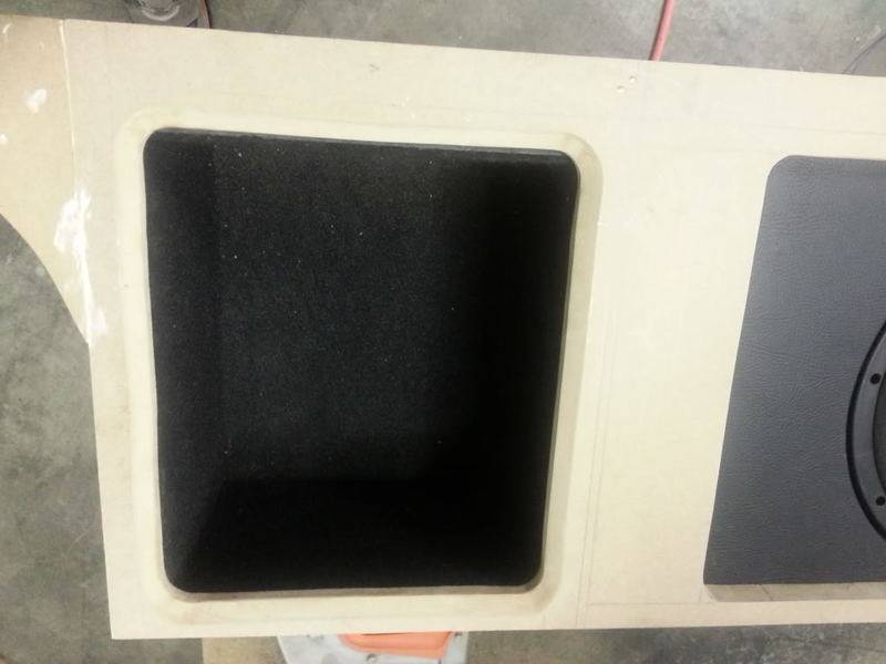

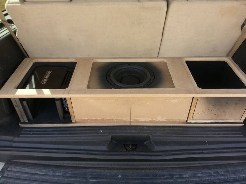

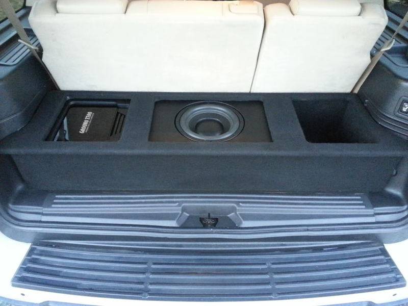

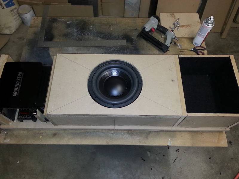

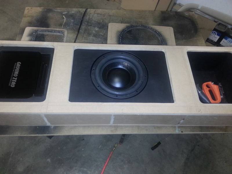

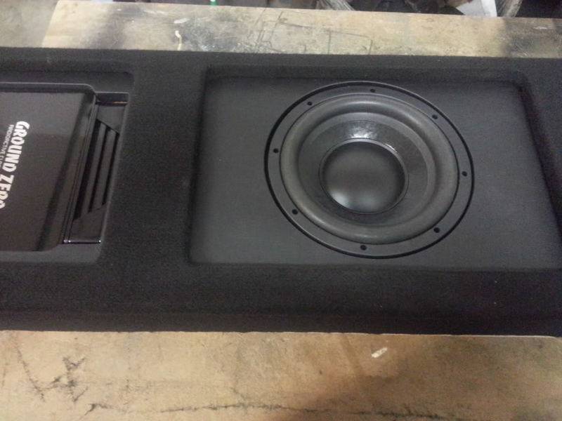

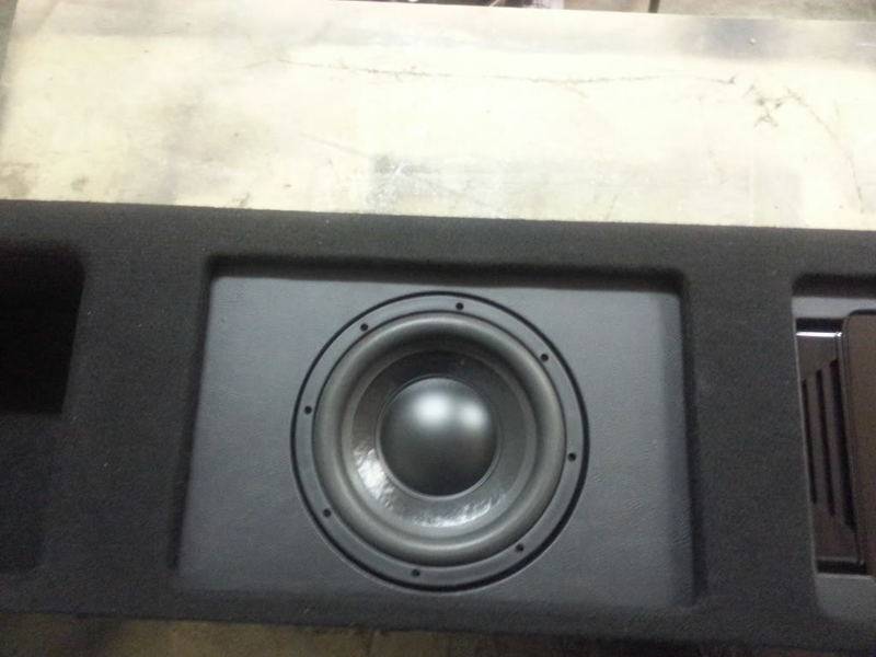

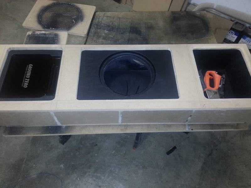

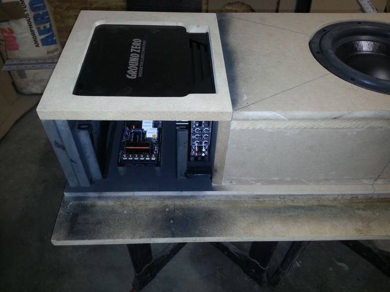

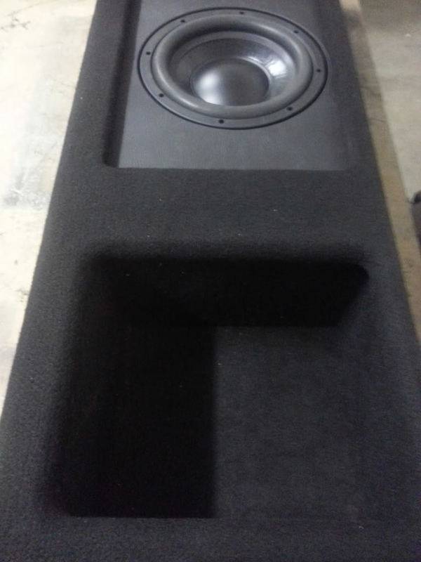

The enclosure and rack
The build came out great in the end. System sound really good, and the 10" ground zero uranium sub blended well with the front. definitely a good sounding SQ sub. But also had great output. The radioactive components fared well also.
