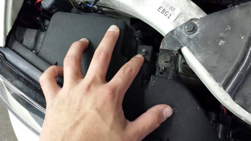

tried adjusting my headlights and i read the manual and that doesnt help at all , please help i tried turning the screw in the picture and nothing adjusted
Just went out and checked to be sure..... That's the height adjustment.
yea thats what i thought but i turned it and it didnt adjust the height , how much should i be turning them , thanks for the quick response
wall at my work , and im about 3 feet away, gen 1 has 2 and gen 2 has 1 horizontal is non adjustable
That's almost too close to notice any change. You can try large changes; like 4 or 5 turns; just remember where you started. I know that at distance, 50-75 feet, a single 'click' is noticeable.
