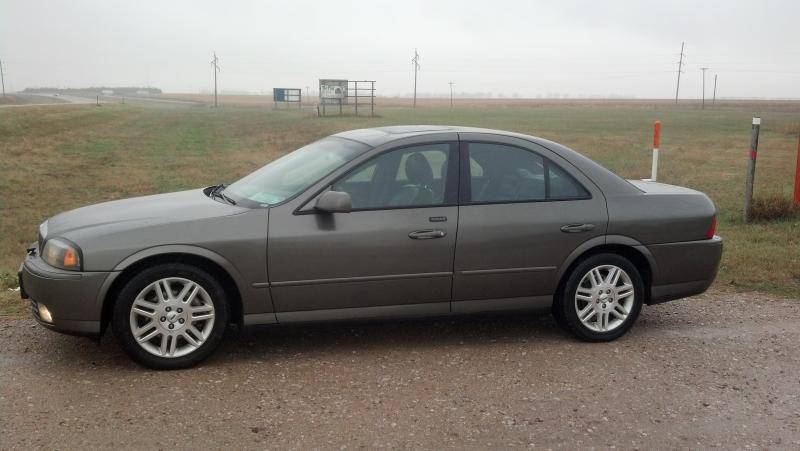

Some of you know I have been wanting to get back into an LS for a while. I'm just wondering inputs if this is worth it or not.S it is a 2004 Sport model 120,000 miles.. it has a sunroof.
the only bad that could be found with the car is that the climate control unit seems to be throwing a 2798 code, It needs a windshield and will probably need two tires by spring. exterior and interior can pretty much be clay bar and or cleaned up and be pretty presentable.
Ford service records indicate tranny fluid was done on the recall 3 coil packs have Been replaced And The SEat heater was replaced on the pasenger side the rail.. it is a Two owner car And all records have been kept very very sound and well maintained.
I spoke with the previous owner who traded it the dealer gave her $4500 on a trade.
the dealers trying to make a thousand dollars at 5500 as it is. I know they're willing to DIcker A little, what the car be worth $5000 or less even if it needed a $700 AC control unit?

The transmission fluid recall was just to add an additive to the transmission fluid, not change out the fluid. My experience (and many others here too) was that the additive delayed the failure of the solenoid assembly, but did not prevent it. If that hasn't been done, count of $700 to $900 if you have someone do it. The 2798 error is from the DCCV, not the DATC. The DCCV is about $300 to have done.

for 5k I will take it. the issue is most likely the dccv and you can get that from rock auto for $100 and you can do it yourself its really easy. now for the bad side. COOLING COMPONENTS it may be time to replace them if they haven't done it yet and also shocks / struts may be time for change on that. you can check the rear tires for any extra wear in the inside of the tires that would tell you its time for shocks. the bounce test don't work on a LS since the shocks have a shorter piston and don't travel a lot.
In that color, it would already be sitting in my driveway for that 5K.
