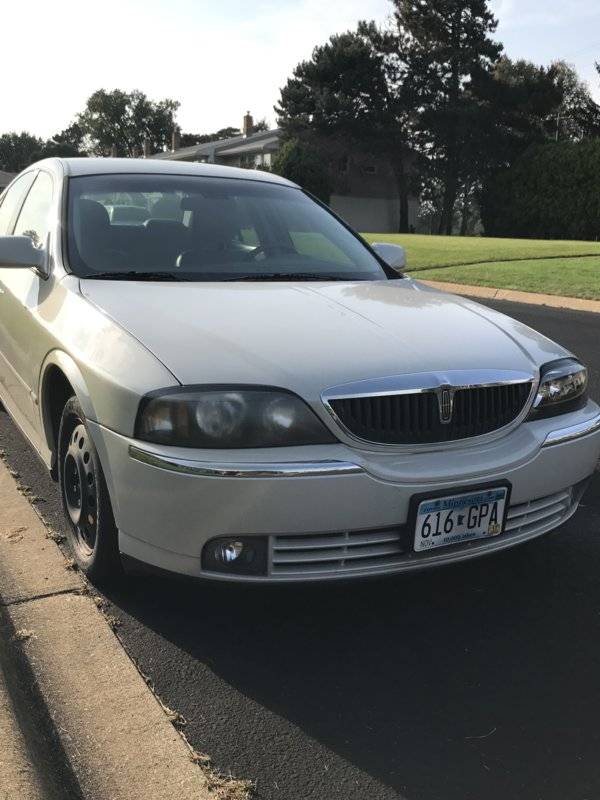

Ok here goes. Inherited this car in 2013. From day one it had a random transmission buck like being rear ended between gears. This would happen between 25-30 miles an hour. The gear would simply slip and I would have to rev the car to 5k rpm or let the car coast down until it found 2nd gear. One fine day w the wife n kiddo it finaly decided not to work at all in G5 or reverse. Took it to a tranny shop they gouged me for a $200 test and said the following. Yes your transmission has a problem but we need to take it apart for a minimum of $1200 to fimd out? Seriously assholes can I get my $200 applied to the bill I already knew it was f$&$d. This is my first official post but I have been reading this forum since 2013 great forum! So the other day I decided to just try and manualy shift the car and guess what it works! I can start in 1st, 2nd, or 3rd gear, shift into G4 at 45mph then G5 at 55mpg. Car does not shudder or kick when slowing down from a stop. I love this car it has only 80k miles, zero rust and barely a scratch on the body. I want to get it fixed but I do not want to get ripped off by a shop! What should I start with? Fluid replacement? The shop said they did find metal bits in the pan when they pulled it. What do I need to be telling the transmission shop so I don't get f$&@d? What w be my max cost on this problem? I just do not wanna dole out 2k to have it also be a PCM issue. At that point I have paid as much as the car is worth. Thanks for the help in advance I wanna hold on to this car!
