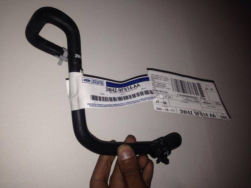

So I just got that part in and it doesn't seem like this is the right one. Is this really the hose that sits UNDERNEATH. The intake manifold? I want to have the right part before I take it apart it's my daily driveimage.jpg
Well, it's certainly the hose used on both of mine. What about it doesn't seem like the right one to you?
If you really had replaced the commonly failing plastic parts before, you would have had the manifold off and seen why this hose makes the turns that it does.
