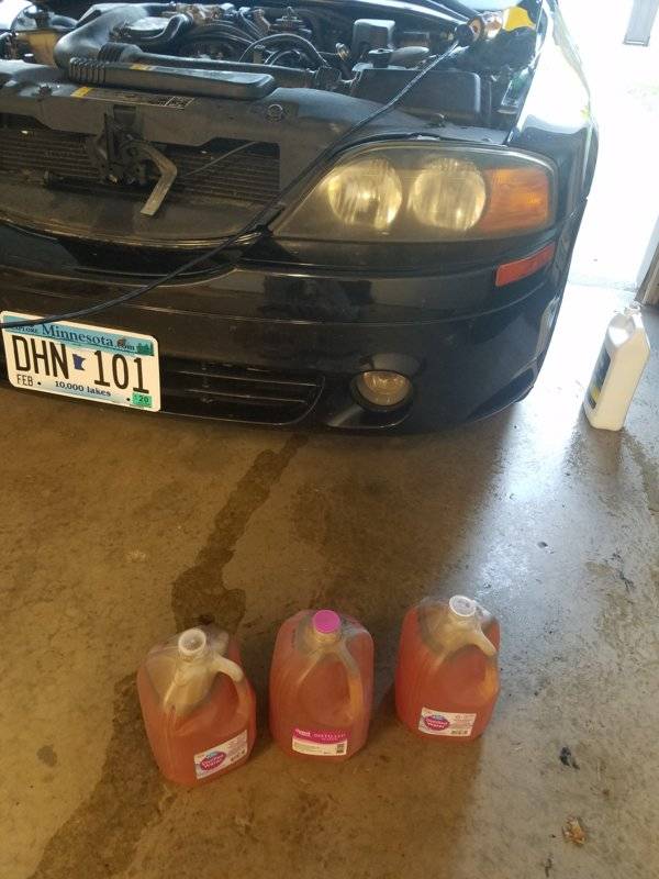

Had to flush out DeX Cool ...the previous owner wasn't a Ford man obviously....:)
